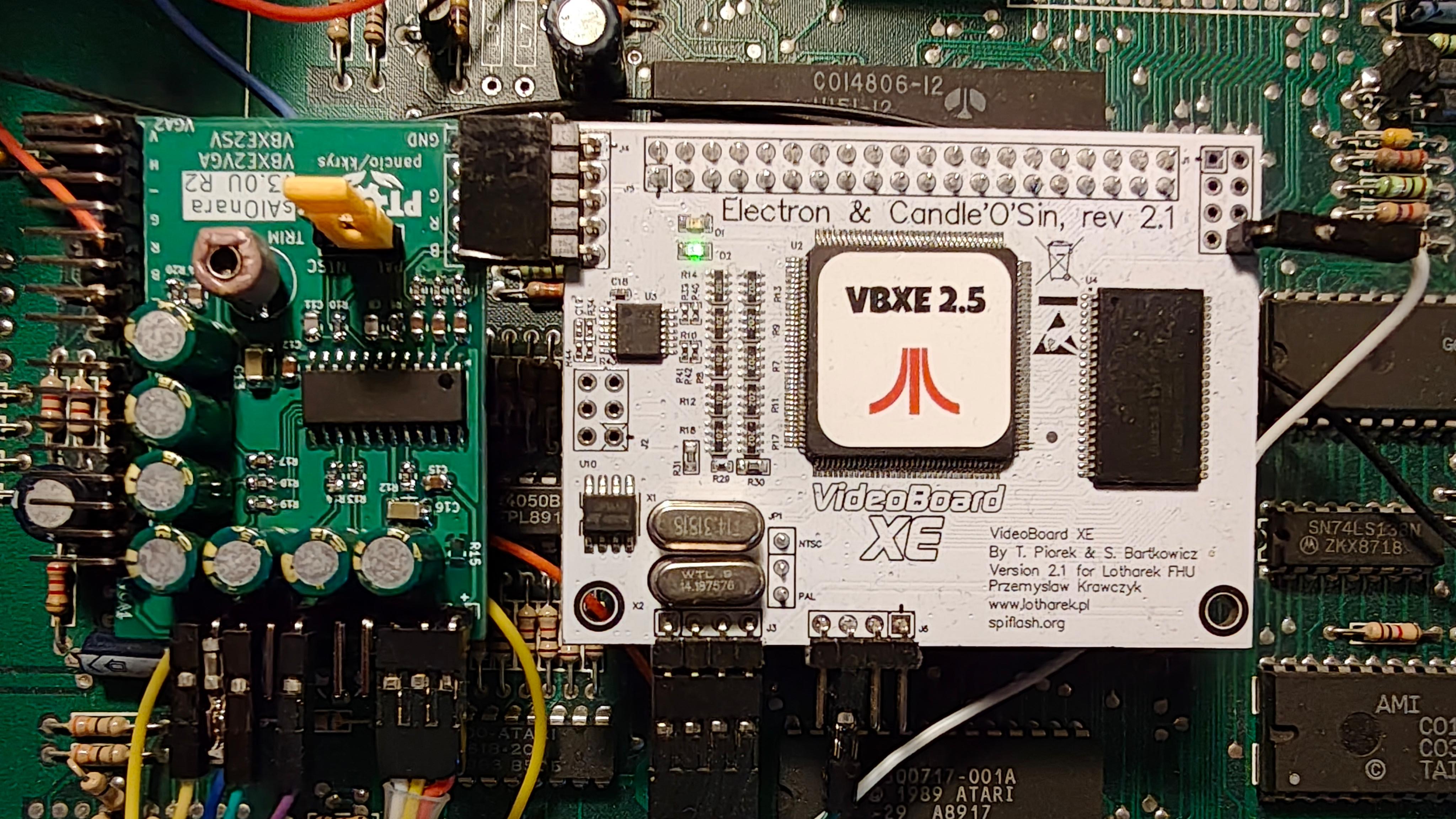

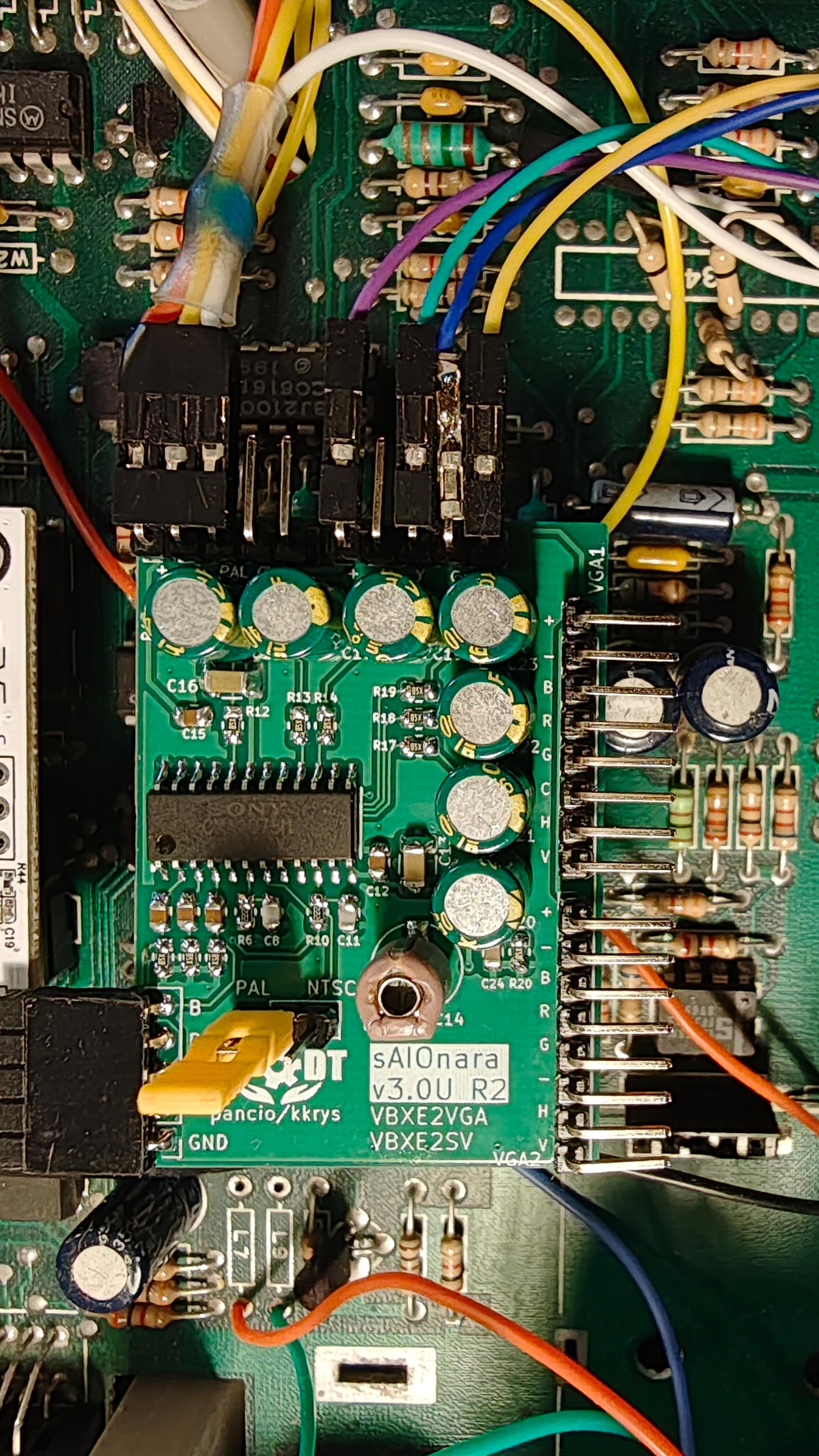

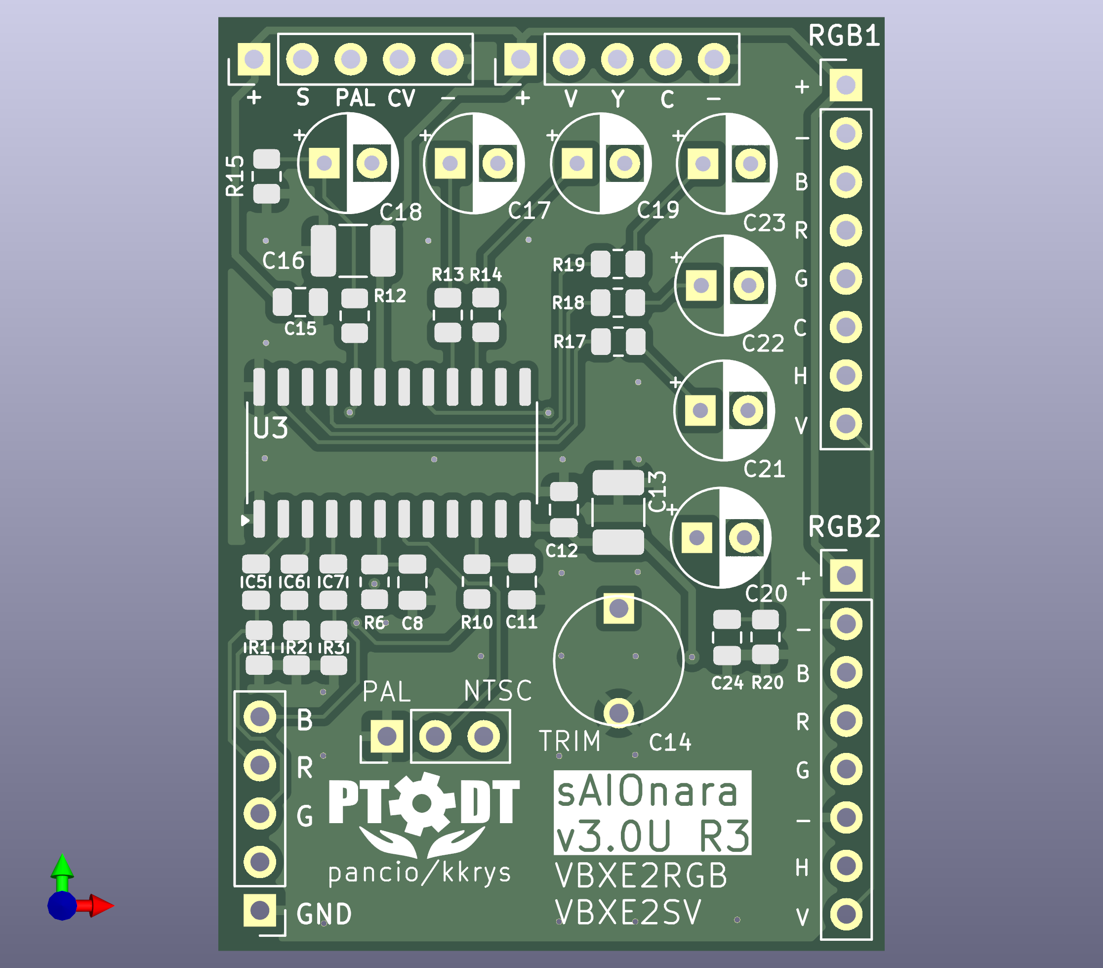

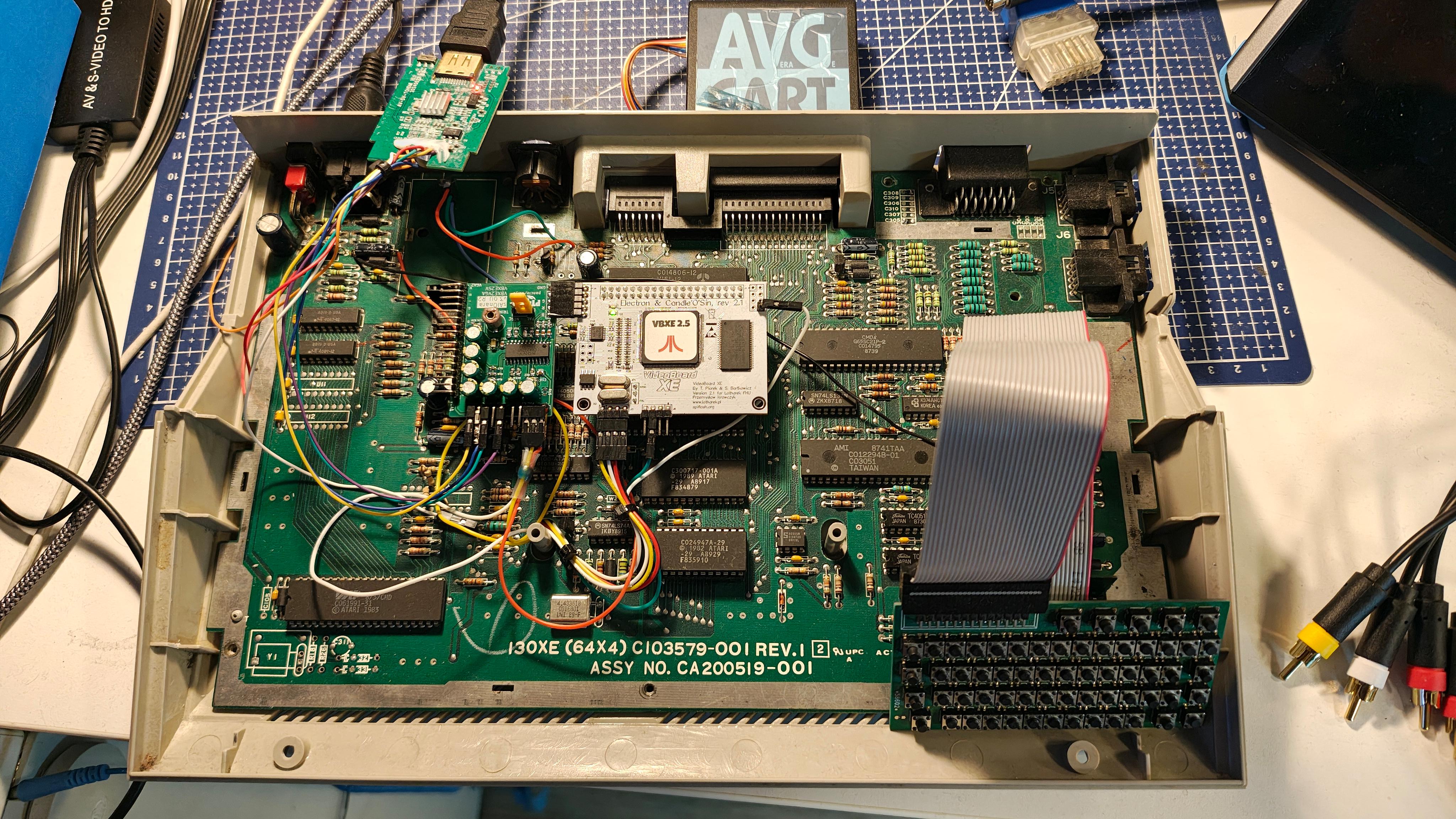

I'm presenting another variation of the SavoNARA – this time based on the CXA2075M chip, a very faithful replacement for the CXA1645M chip. This interface allows for direct connection of two RGB outputs, one S-Video, and one CVBS.
This chip is designed for VBXE users who don't want to drill holes in their case and want to enjoy VBXE effects using the original Atari video output (DIN5). Of course, it's also possible to output RGB signals (H and V separately) externally to the computer.
The THS7314 amplifier also buffers and separates the VBXE signals, allowing for simultaneous connection of two RGB receivers – for example, a monitor and an RGB-to-HDMI converter.

The CXA2075M simplifies board complexity because it doesn't require as many passive components as the CXA1645M. This also allows for a smaller PCB footprint and easier component placement.

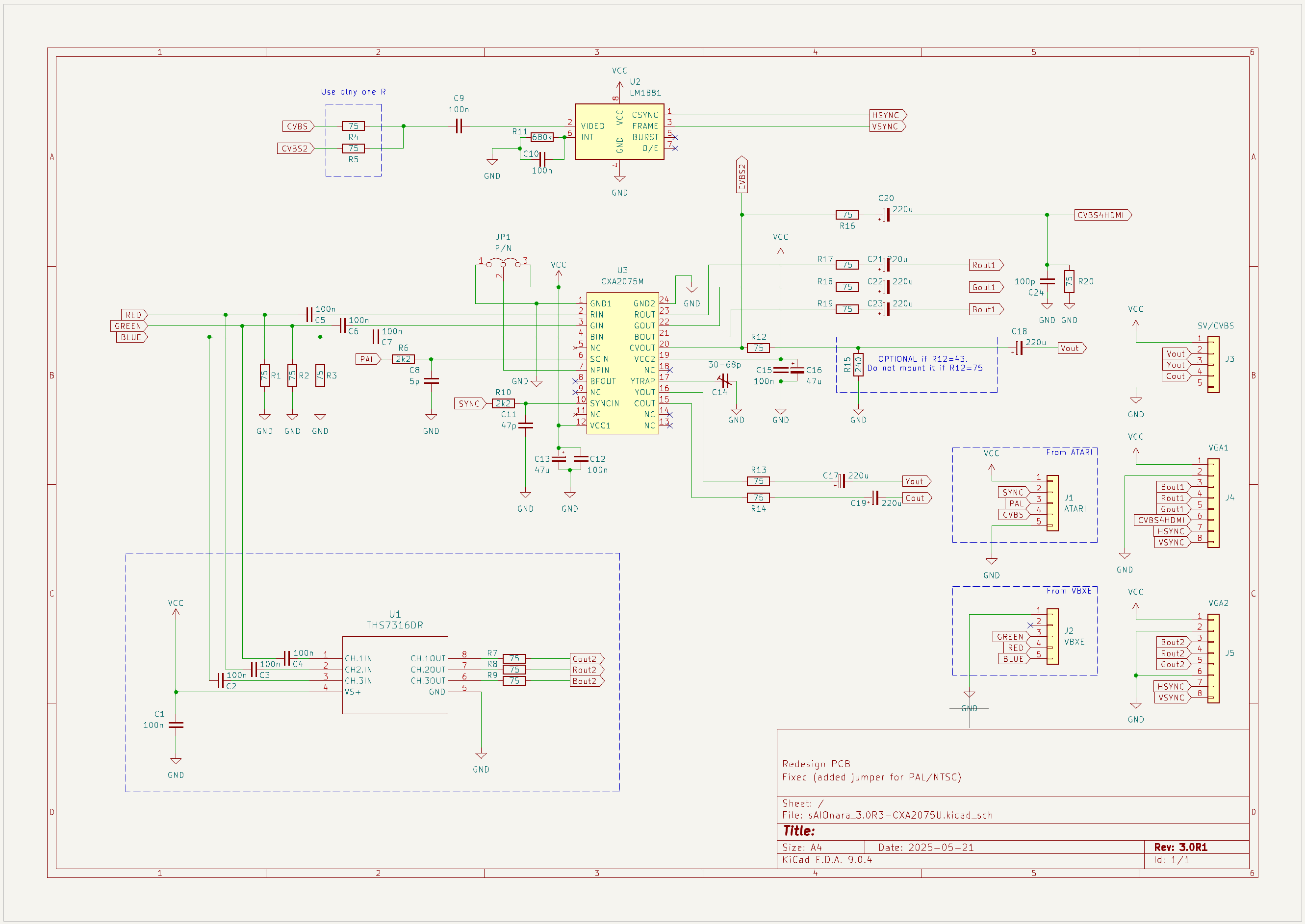

Schematic
The device structure is shown in the diagram below:
SavoNARA-2075U
SavoNARA-2075U

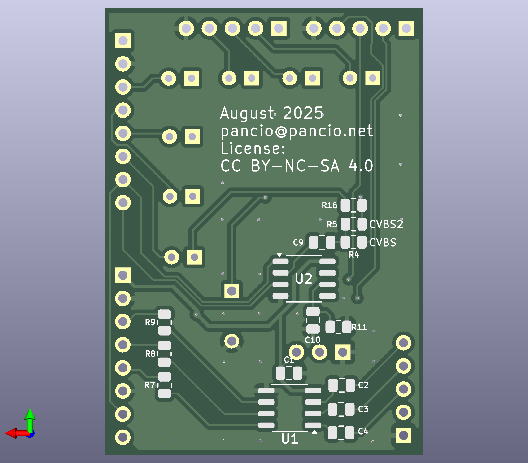

Board
A few pictures...
