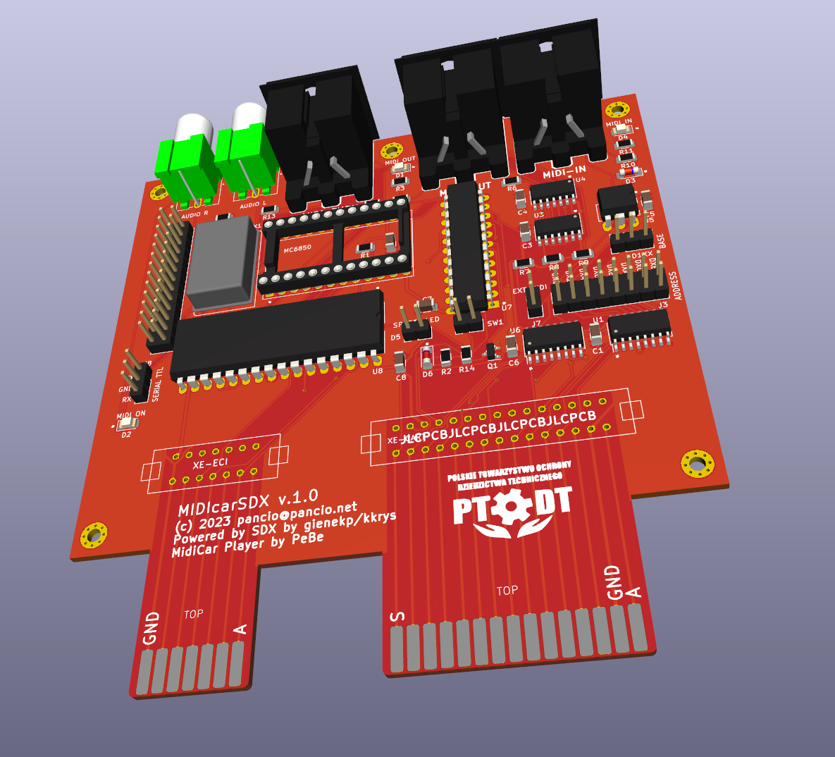

I would like to present new very usable variant of MIDIcar called MIDIcarSDX. The idea is to have MIDIcar ready to use without any external device, so I decided to add cartridge with SpartaDOSX equipped with PeBe's Player on CAR: device.
MIDIcarSDX Prototype PCB

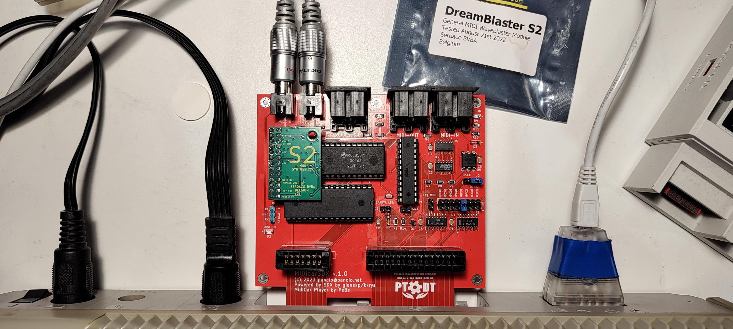

MIDIcarSDX working prototype

By default SpartaDosX is running just after Atari power on. If you want to disable this feature (e.g. need to run SDX form other source like AVG/SUBcart) push button on MIDIcar during boot process. Working mode (SDX/noSDX) is marked as status LED.
If you want to run MPC (MIDI player) just type:
CAR:
then
X CMCP
or
X CMCP /ADXXX
if MIDIcar wasn't detected properly (change /DXXX to valid address)

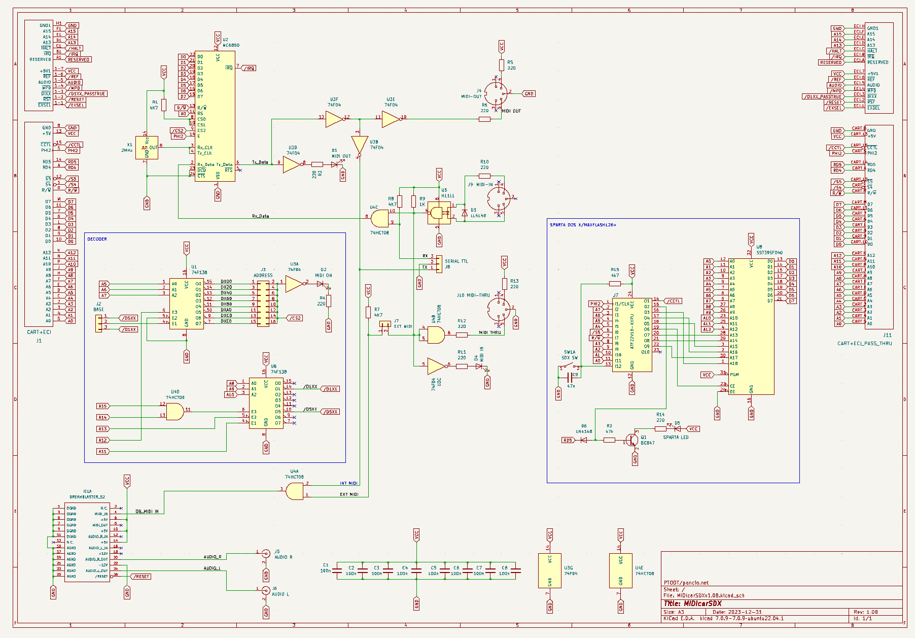

Schematic
Schematic
