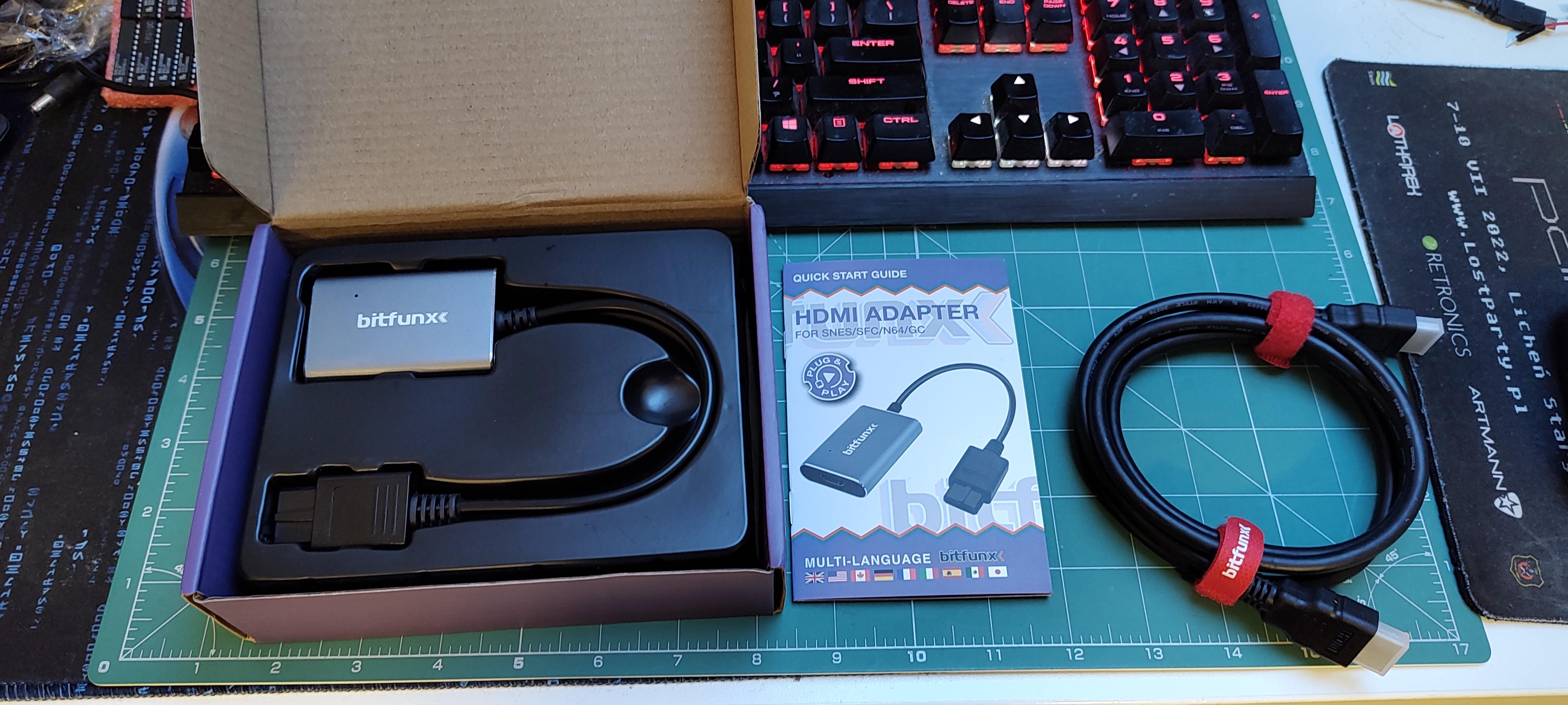

Atari is not the only computer that has problems connecting to newer TVs and monitors. So I concluded that it must exist for consoles such as PS1/PS2 or Wii or SNES. The common feature of all these devices is the way of transmitting the image to the TV... S-VIDEO! And since Atari also has two S-VIDEO component signals, such as Luminance (+synchronization) and Chrominance, the adapters dedicated to the above consoles should also fit Atari. Of course, I assumed that a modification would be necessary :-)
I bought a dozen or so different models of adapters, but most of them are based on Compisite signal processing, the use of which produces a barely satisfactory image. One of the purchased adapters turned out to be a hit!
https://www.aliexpress.com/item/1005006 ... pt=glo2pol

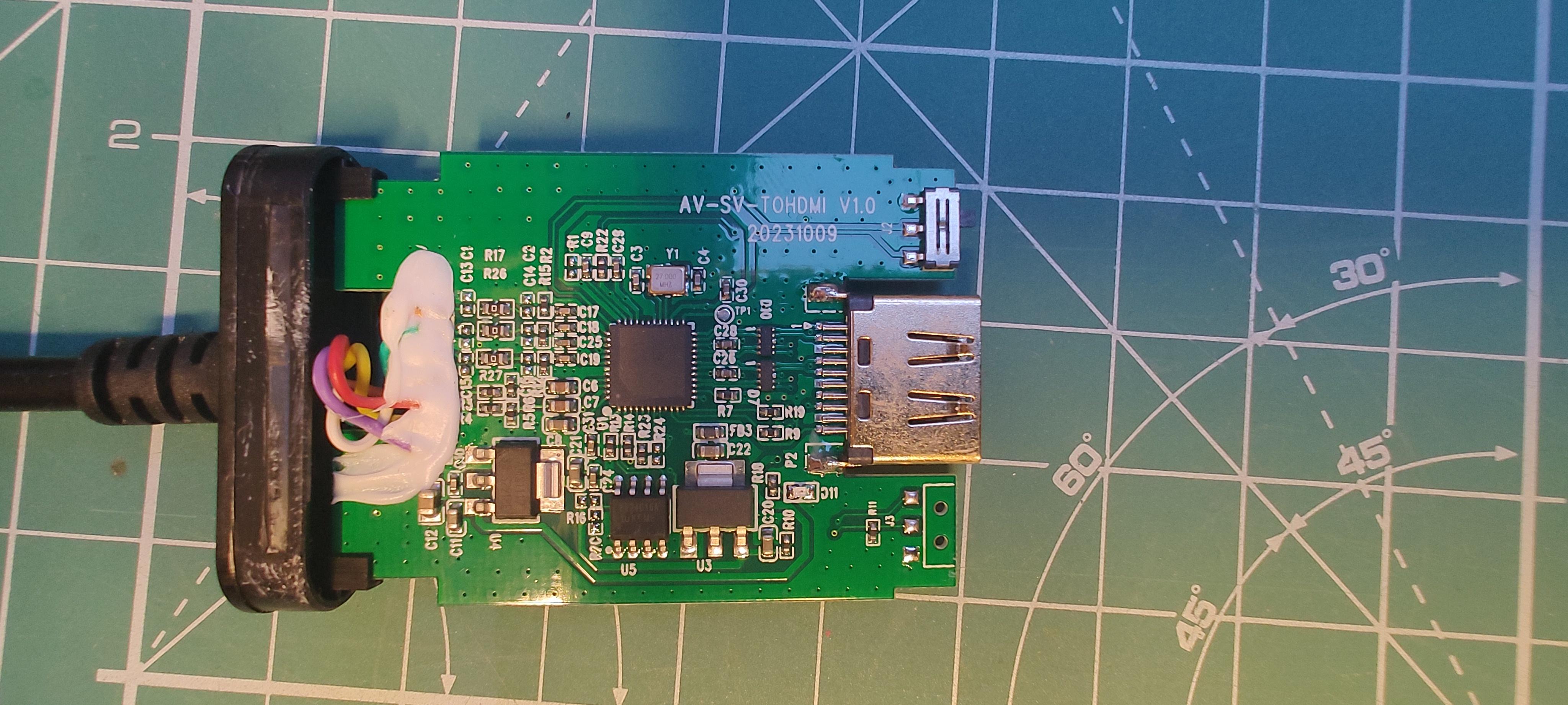

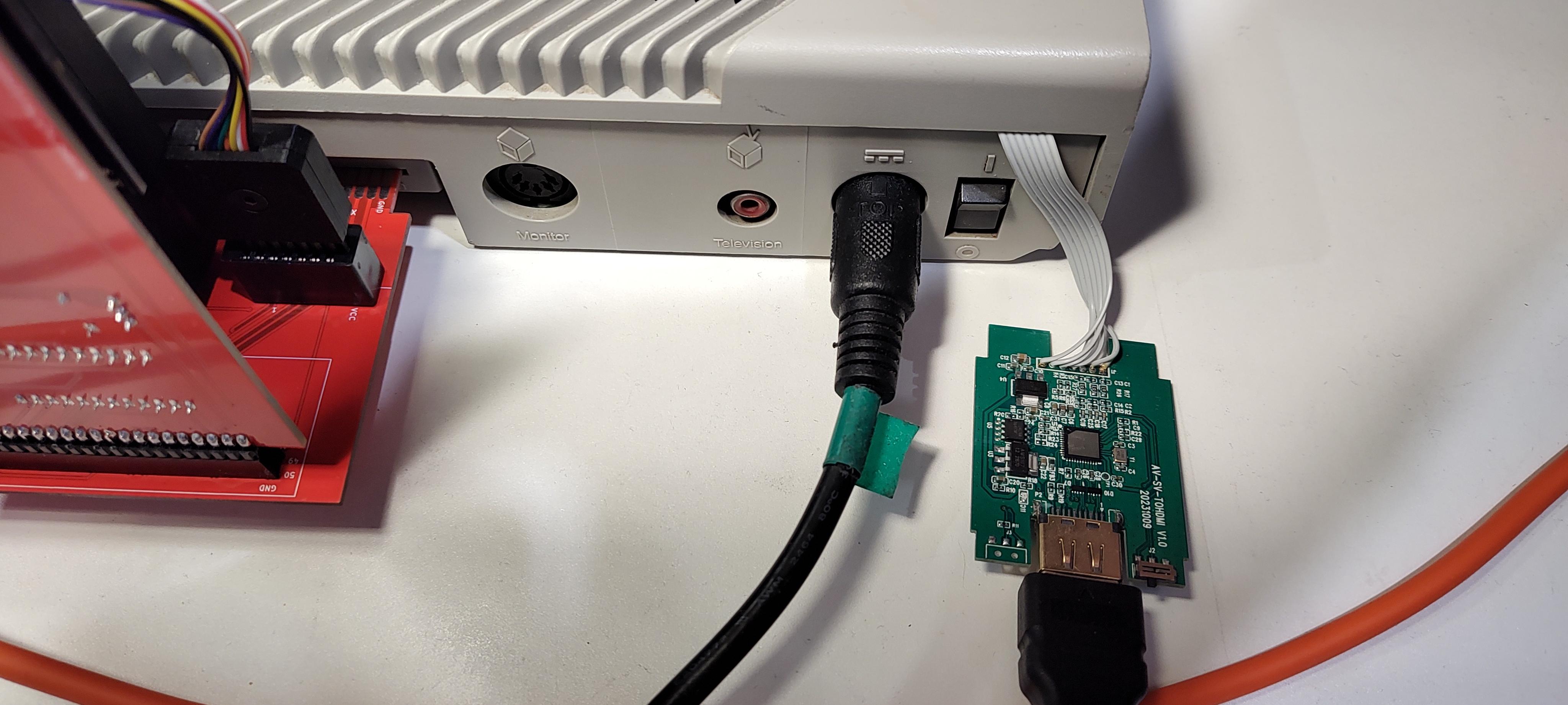

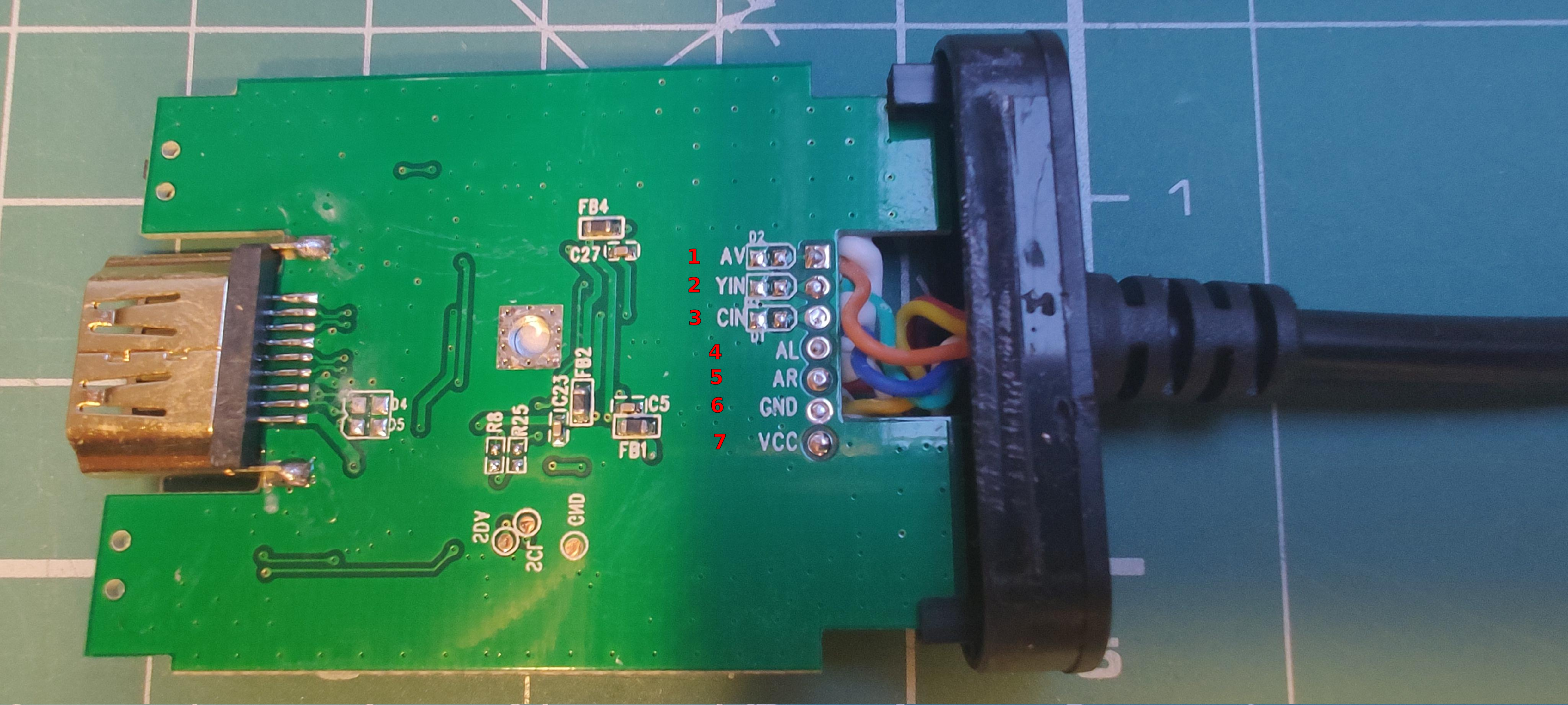

The adapter as in the photo below should be carefully disassembled, starting from the plastic cap near the HDMI socket. Just pry it off with a sharp tool from both sides.
Then we pry off the second cap (the one with the cable) and push it out, pushing the PCB inside the aluminum housing.

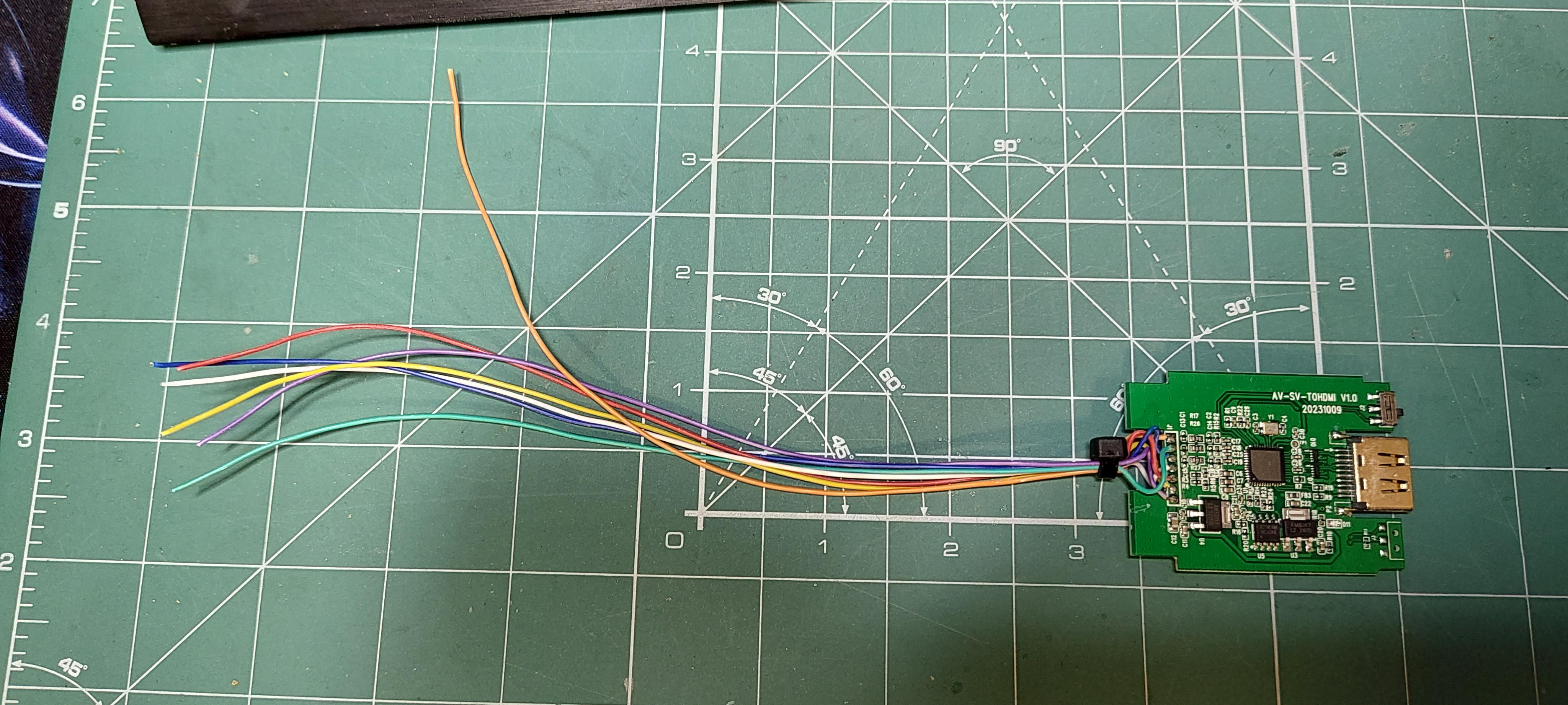

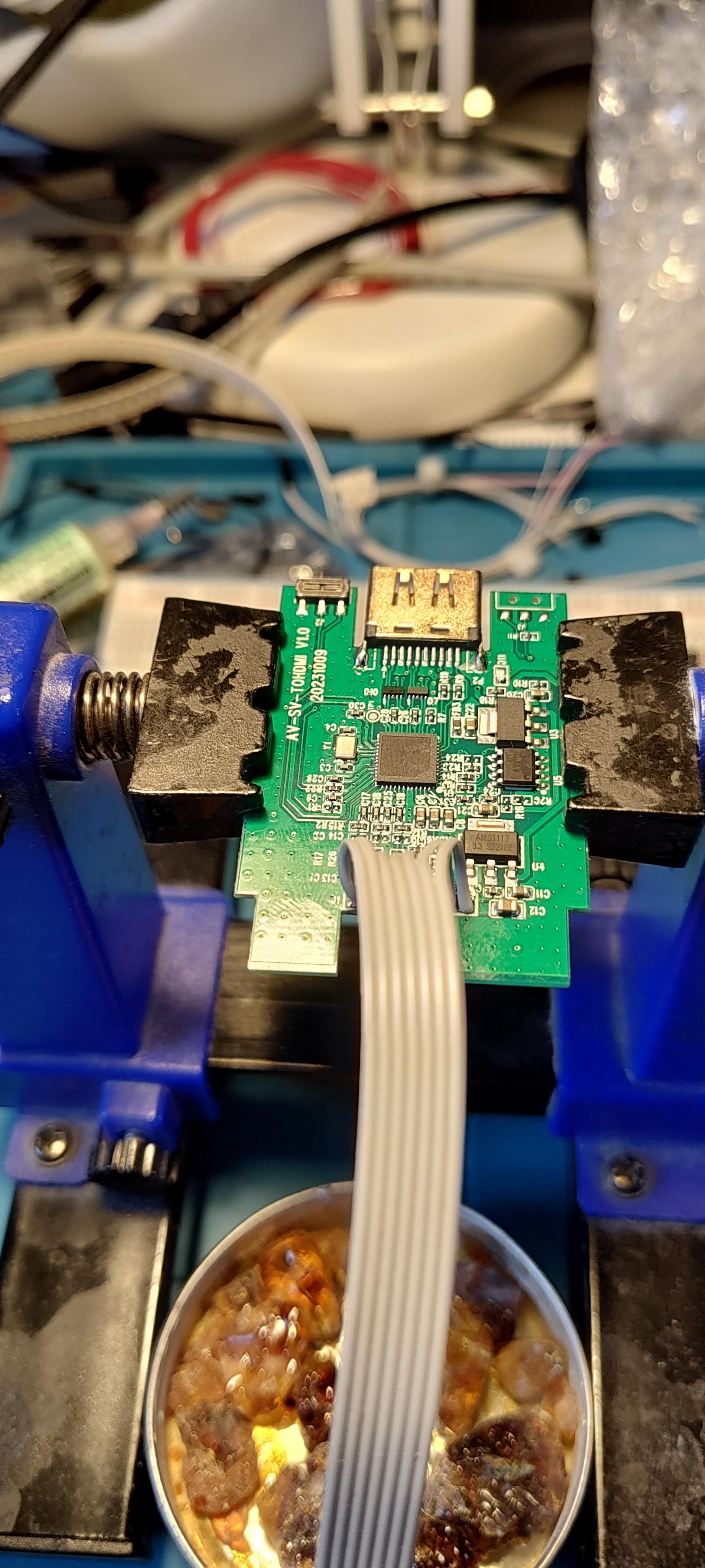

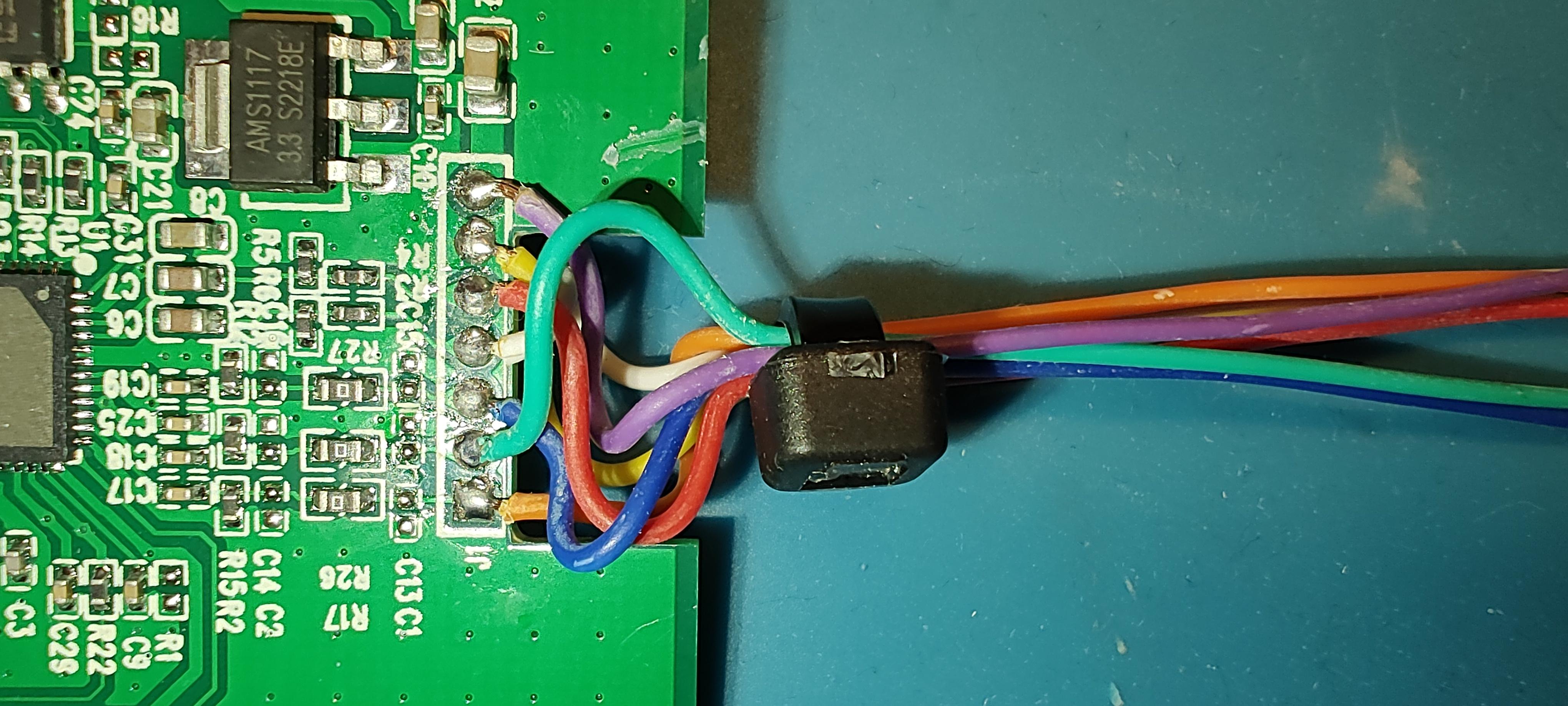

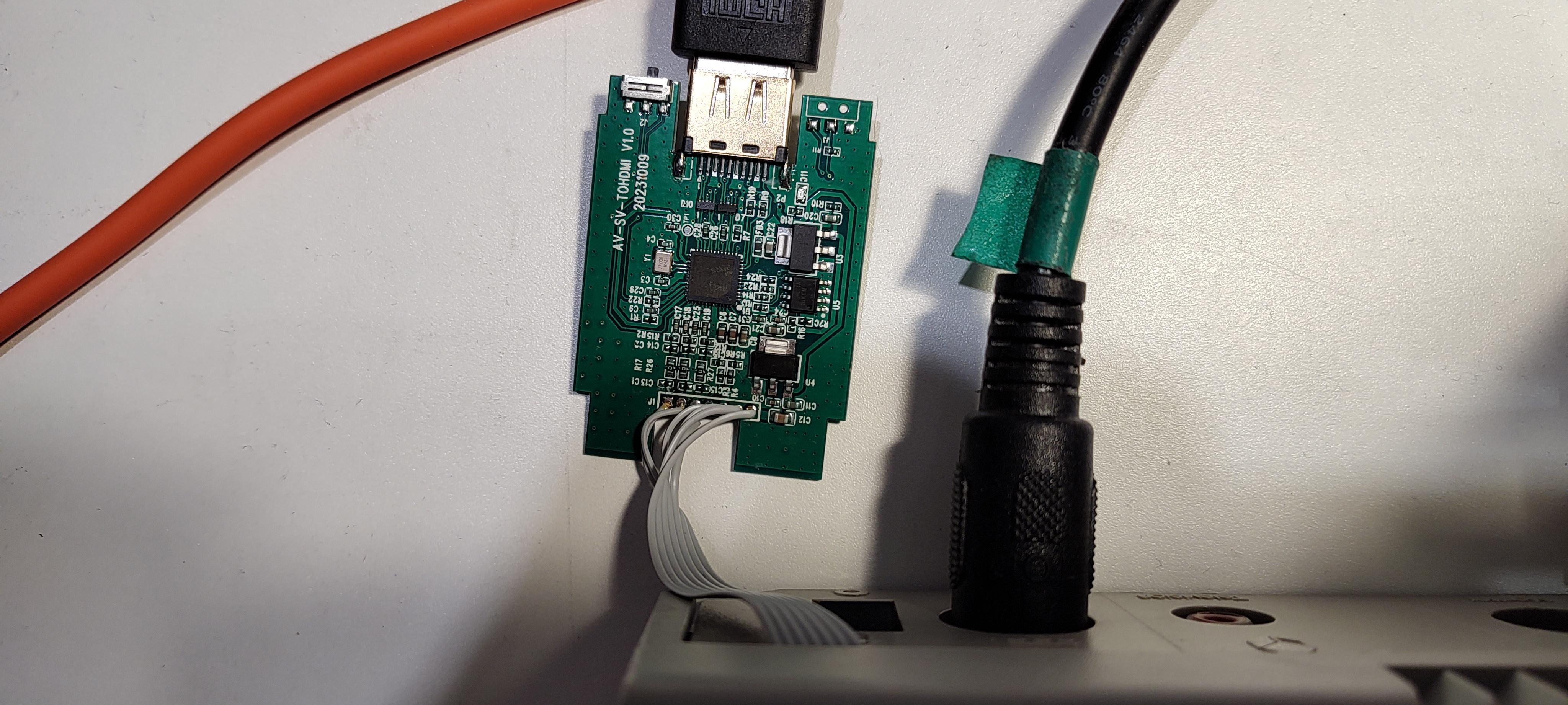

Now it's time to solder all the cables. Carefully remove the silicone glue from the cables and desolder all the cables one by one. Then clean the soldering holes and solder a set of wires approximately 20 cm long. These may be cables such as FDD tape.
Update.
Alternatively, you can leave the original wires after gently removing the insulation from the cables:

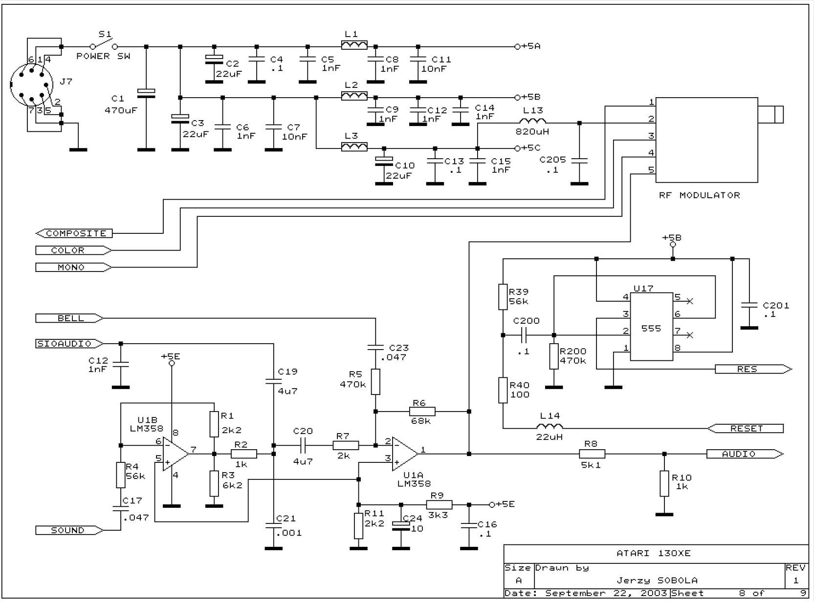

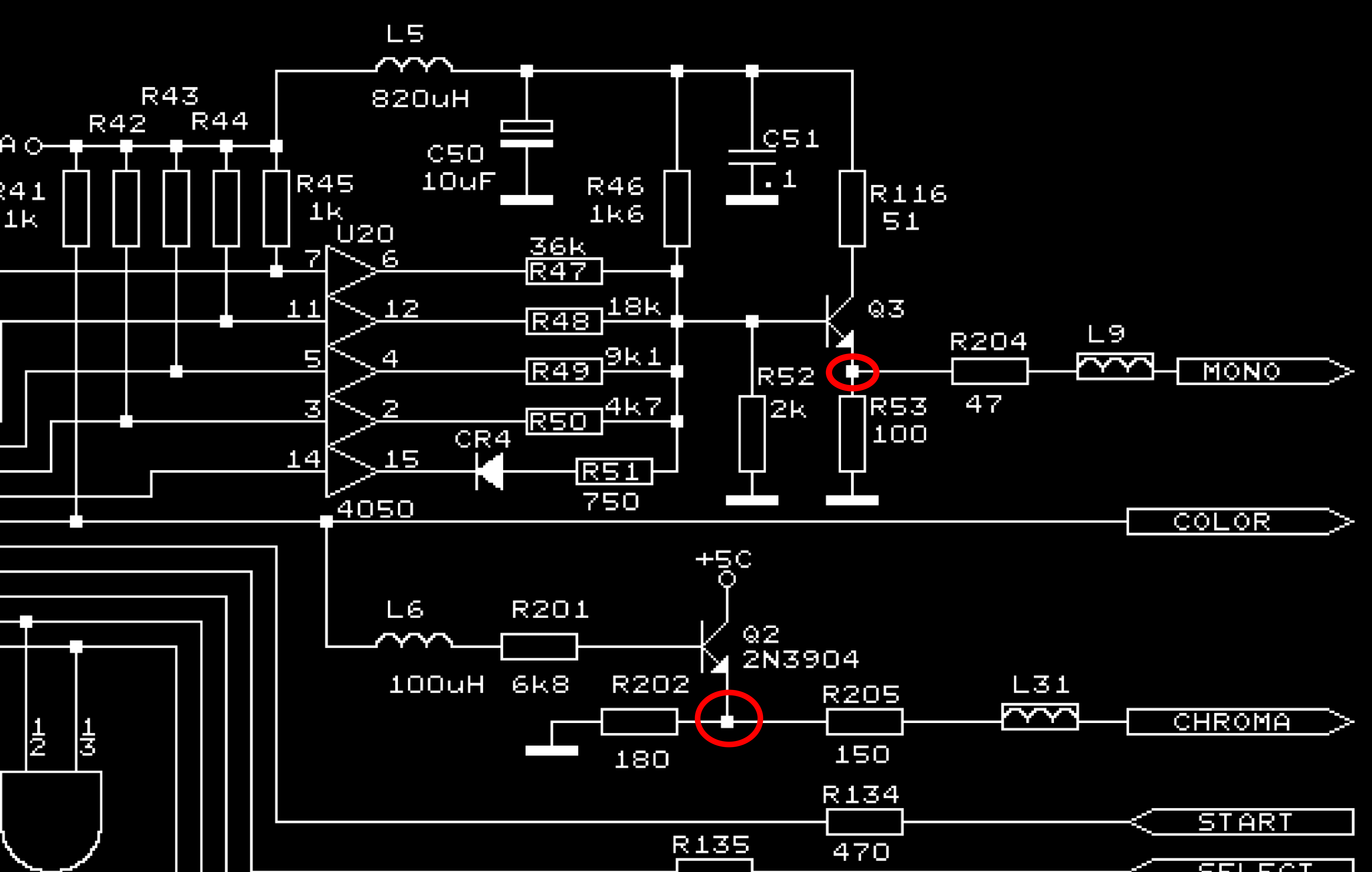

Now it's time to connect all the required cables to the Atari board. We need to connect all the wires as described:
Atari 130xe:
1. ORANGE - CVBS (this one shouldn't be connected).
2. GREEN - Luminance (+synchronization) - connect to Q3 emitter.
3. BLUE - Chrominance - connect to Q2 emitter.
4. WHITE - Audio Left - connect to pin 5 modulator's pinheader
5. RED - Audio Right - as above or... if you have POKEY Stereo Mod - find Audio output pin on it.
6. YELLOW - GND - connect to ground.
7. PURPLE - VCC - connect to power e.g. pin 2 modulator's pinheader.
If you get an image that is too bright, connect the luminance through a 10ohm resistor. Similarly, if you have too much color - connect chrominance a through a 27ohm resistor. Resistor values can be selected experimentally... You may exchange resistors R26 and R27 on PCB.

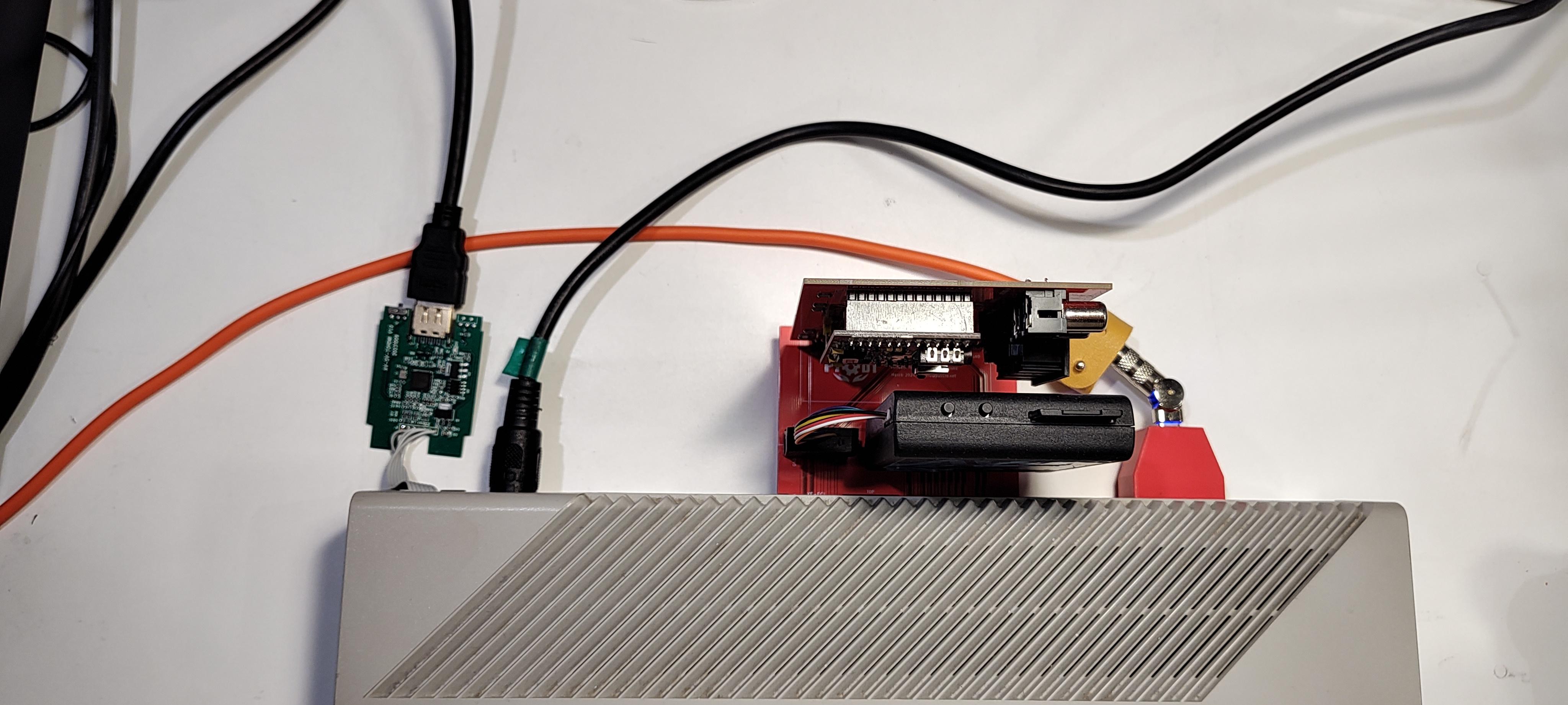

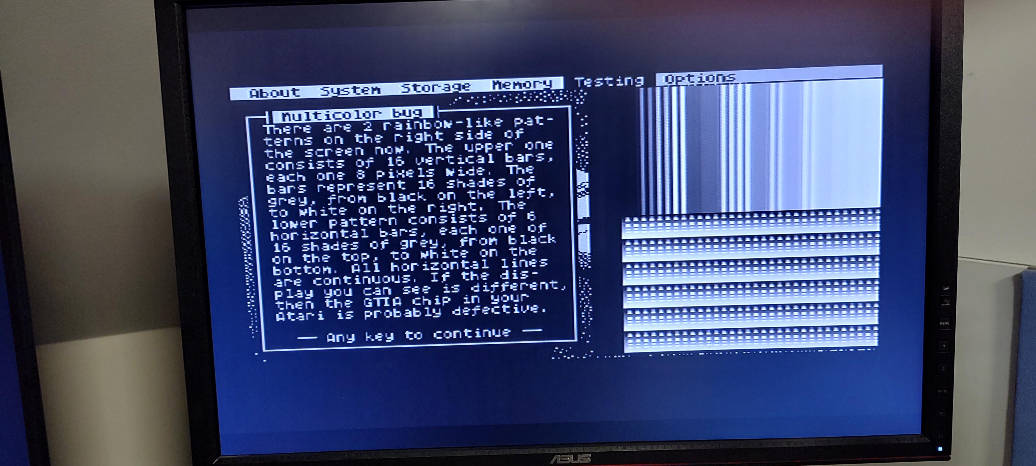

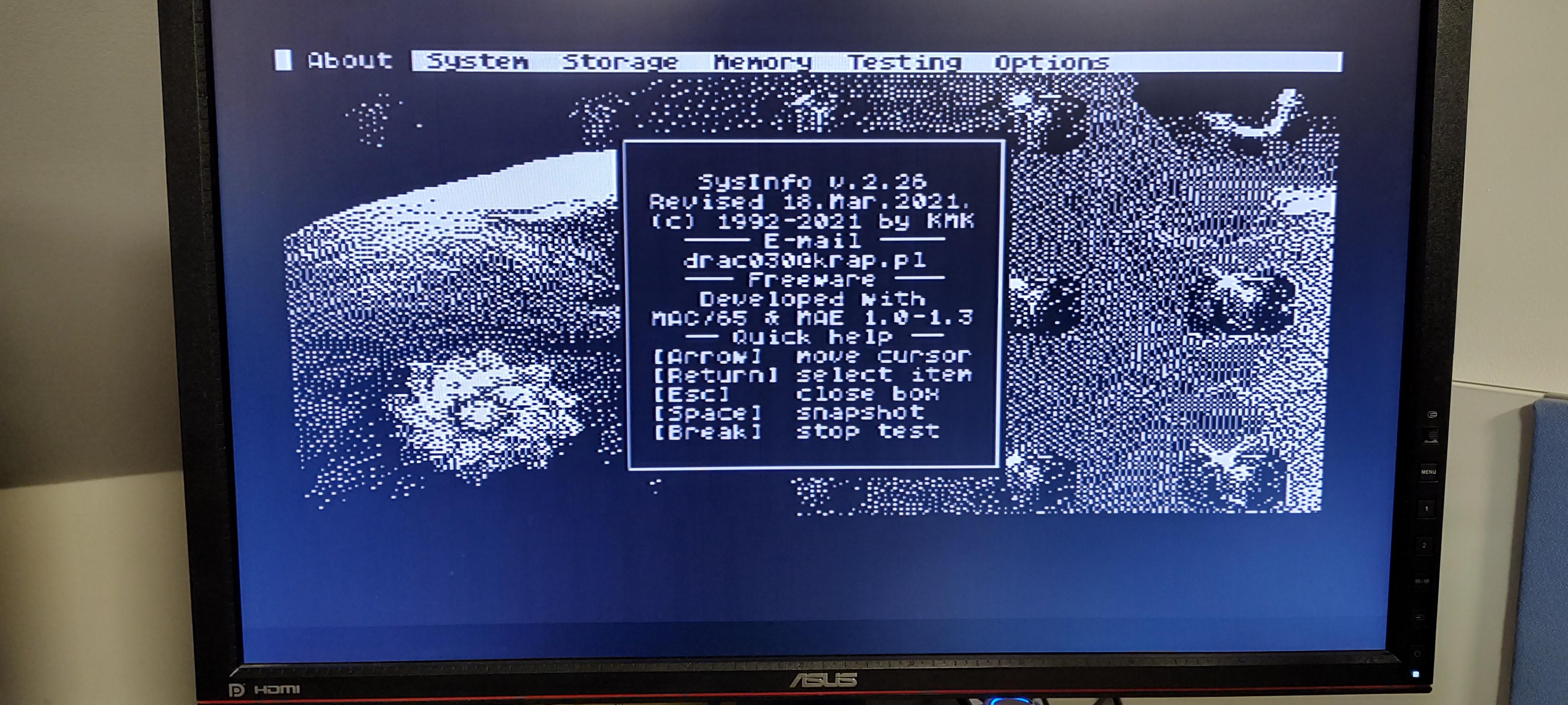

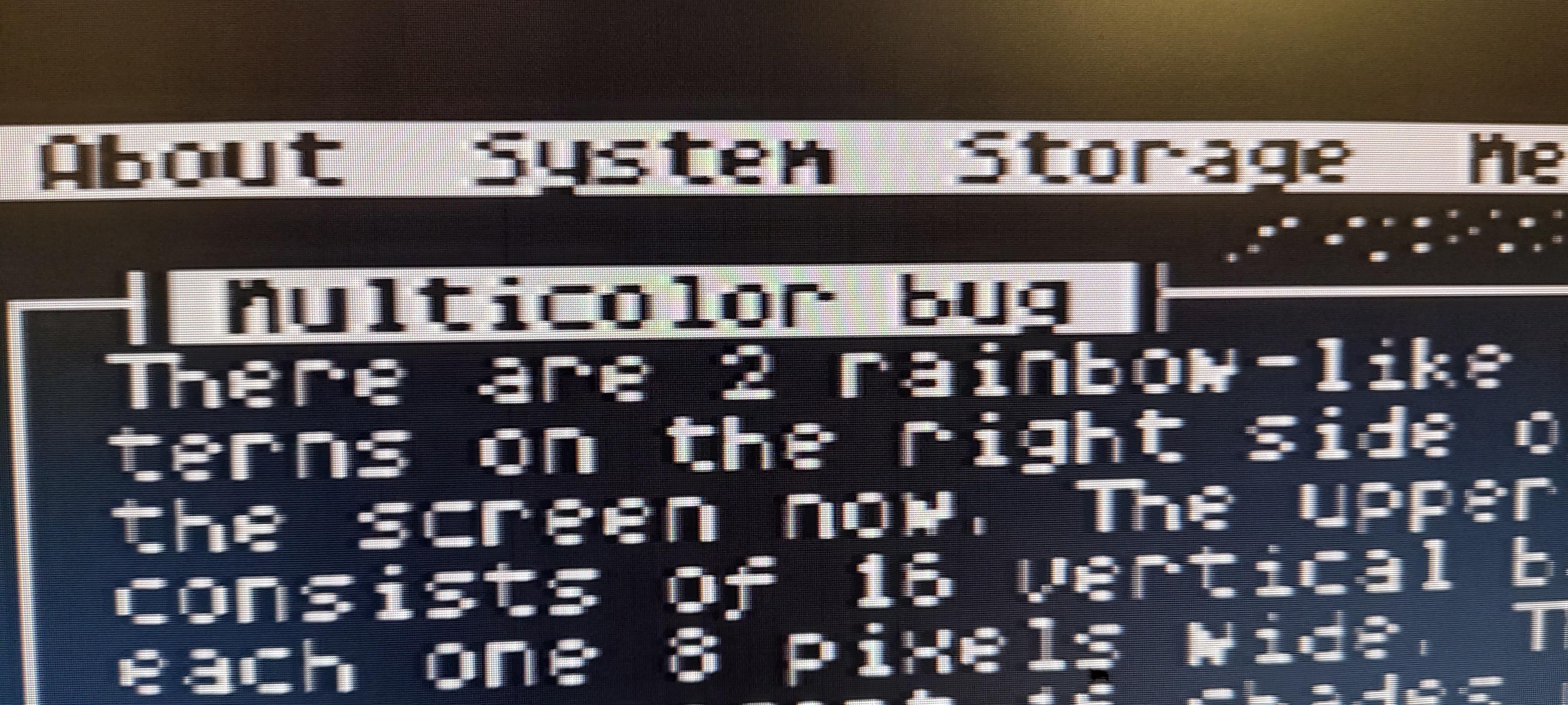

Results

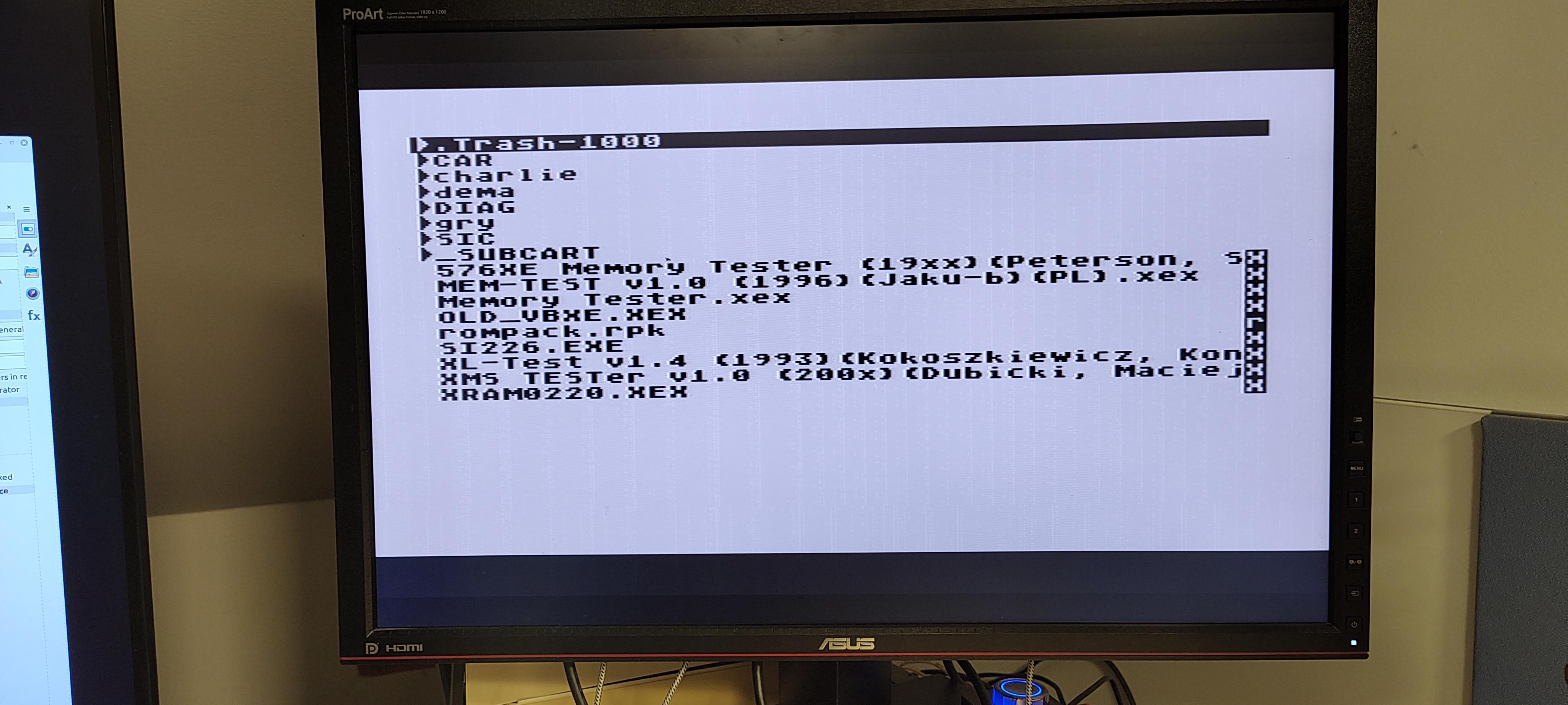

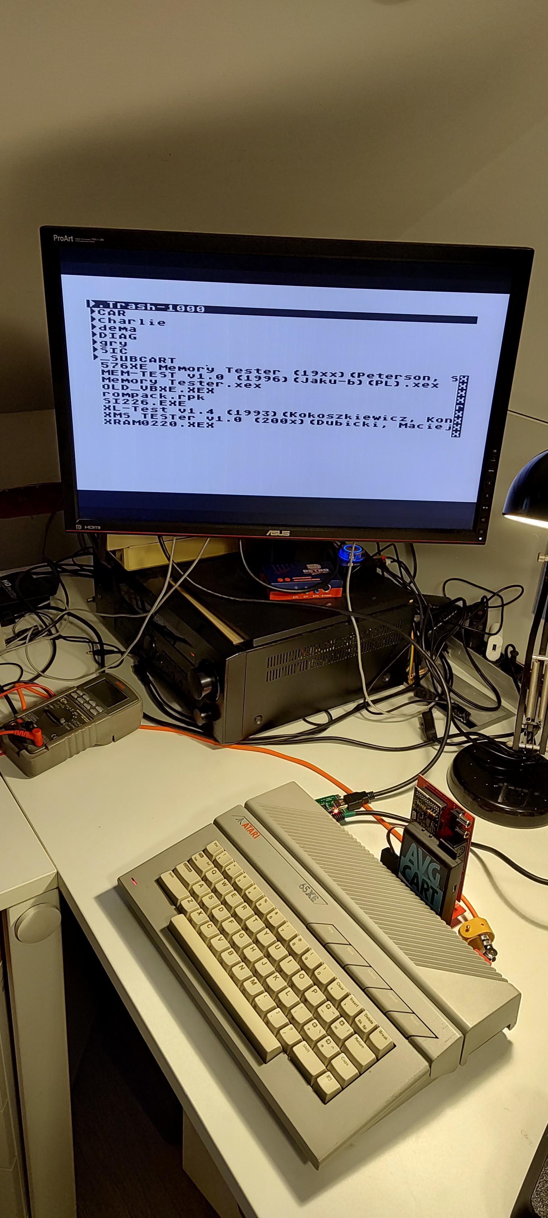

Well.. in my opinion.. impressive! TV55" with Black Lamp... amazing!
