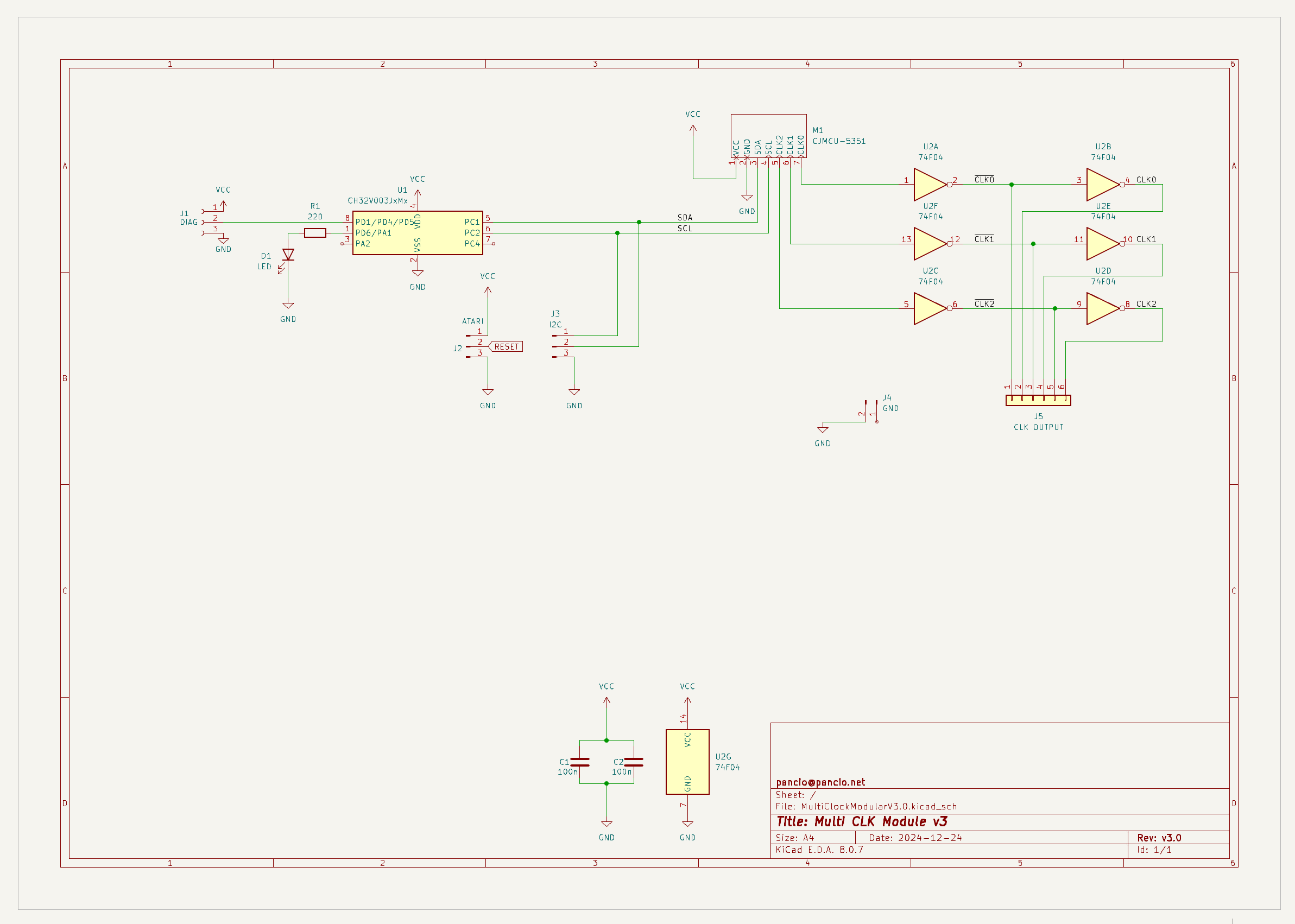

I would like to show you little different clock for your Atari... it's called Multi Clock Module and based on Si5351A programmable VCXO chip. The idea is to have all required frequencies on one board for all Atari models. How to do it? Si5351A has three independently clock generators which can be set to different frequency using I2C bus... so we need additional component like micro-controller in order to set proper frequency on each output channel. Schematic and PCB is very easy and anyone can make own device in home. I decided to use common module CJMCU-5351A instead Si5351A chip on my PCB because full equipped CJforum@systemembedded.euMCU-5351A (or clone) is cheaper than Si5351A! Strange but true.

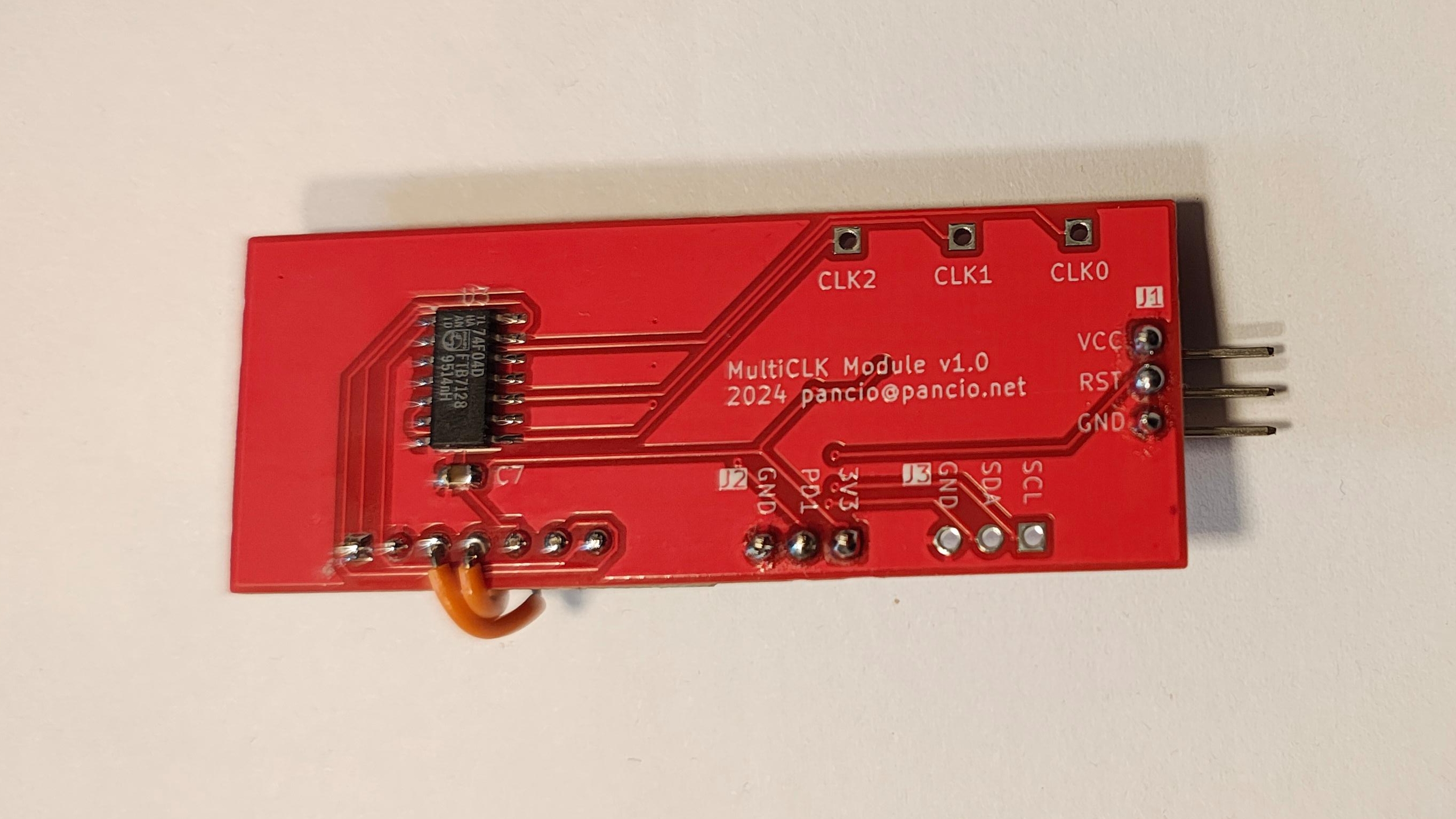

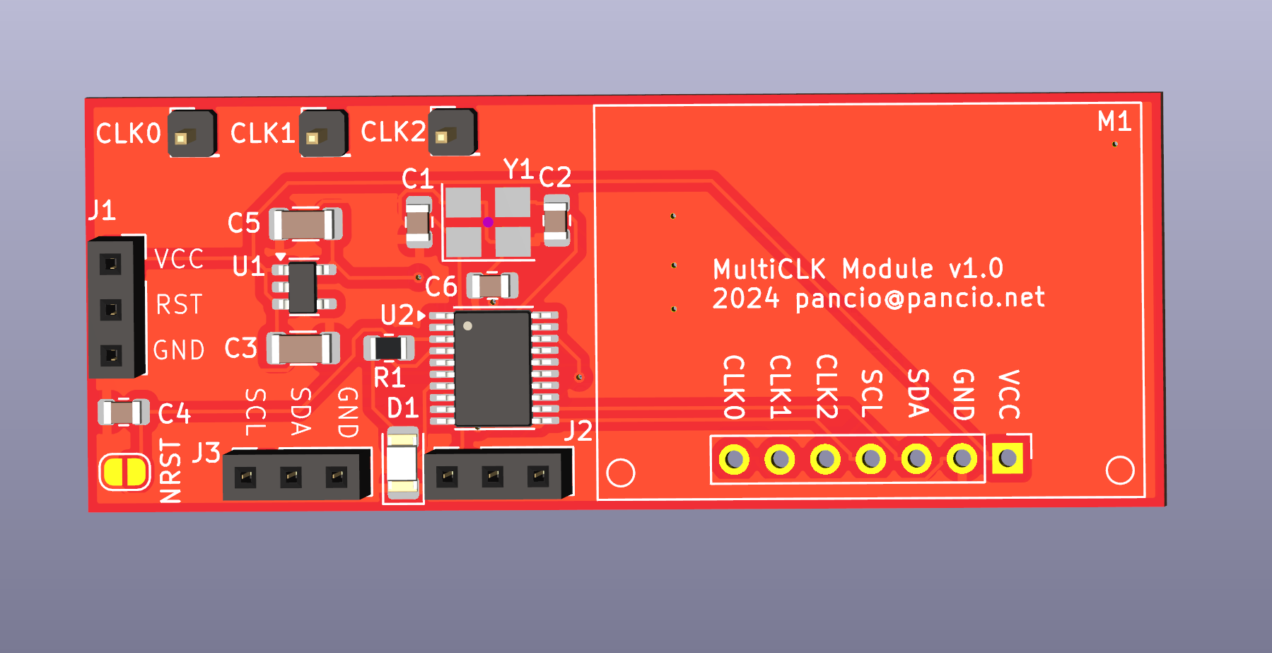

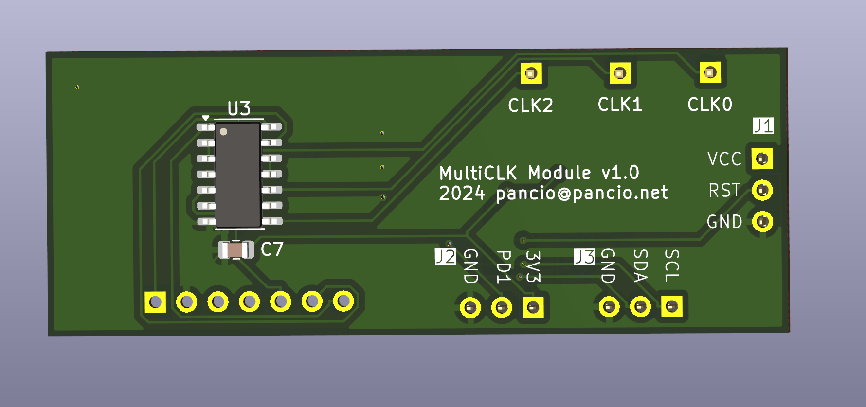

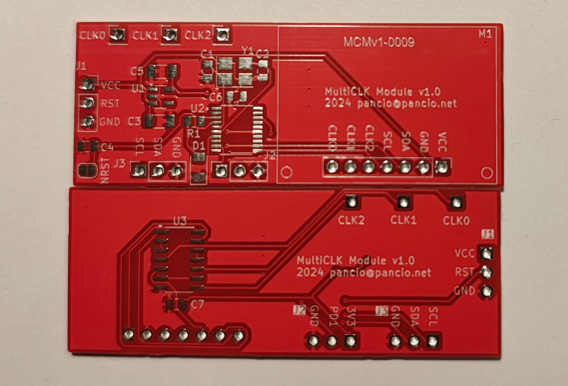

PCB design
MultiCLK Module PCB top view
MultiCLK Module PCB bottom view

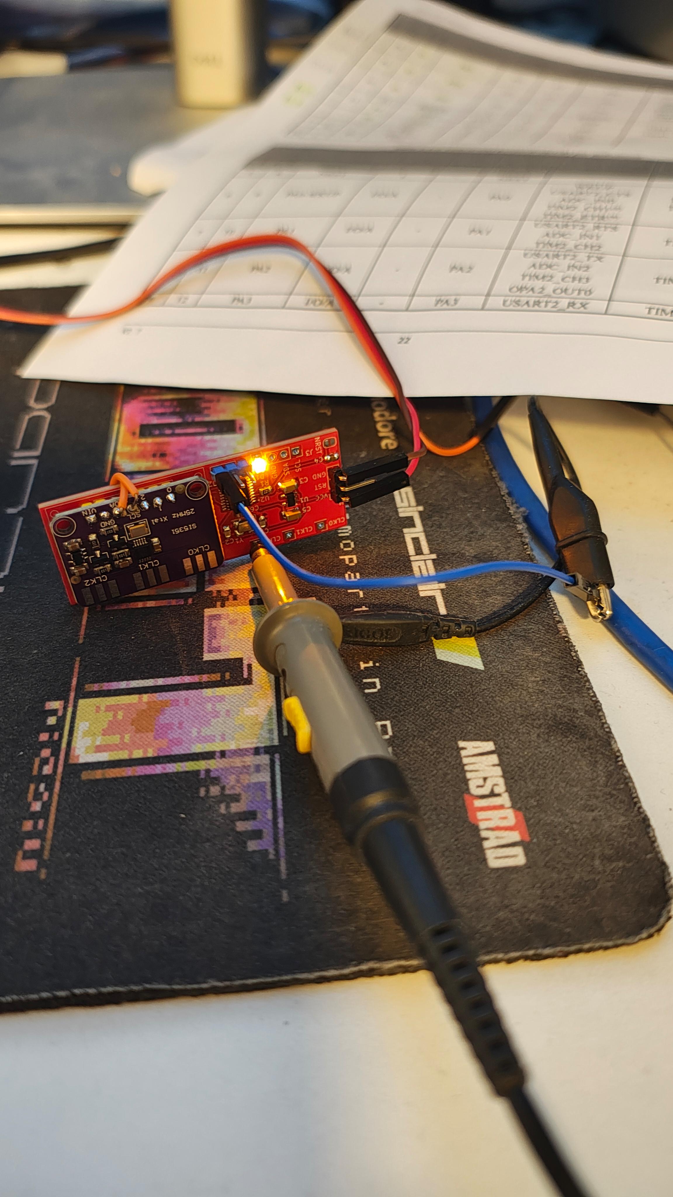

Working prototype

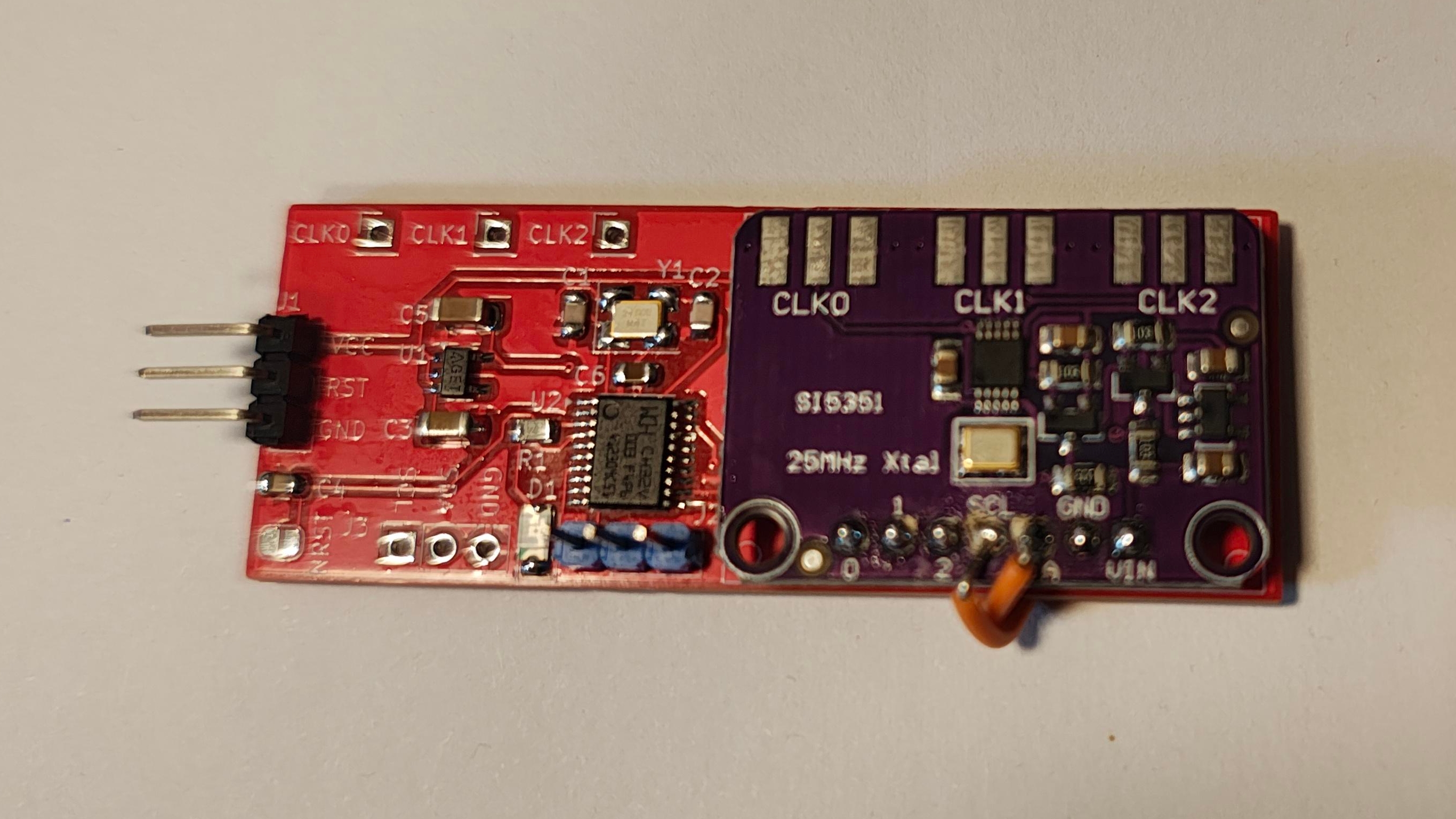

A few days ago I received PCBs - looks nice... ready for assembly :-)
Assembled PCB:
As you can see in the pictures, it was necessary to use two cables that swap SDA and SCL. If you have PCB v1.0 - please remember to fix it! Version MCMv1.0.1 is free of this bug.

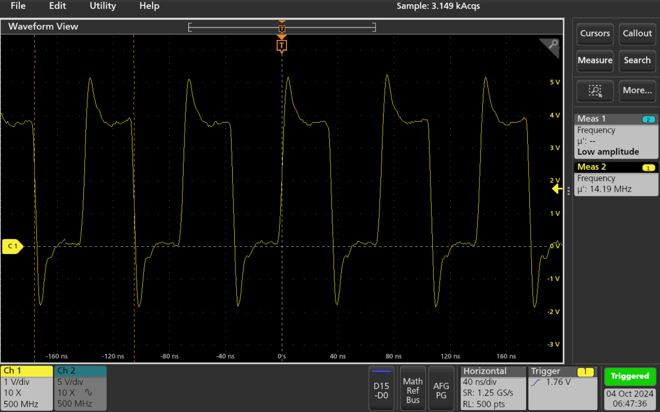

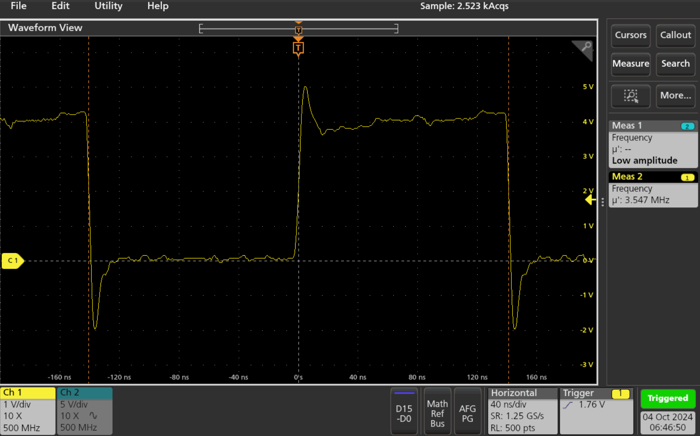

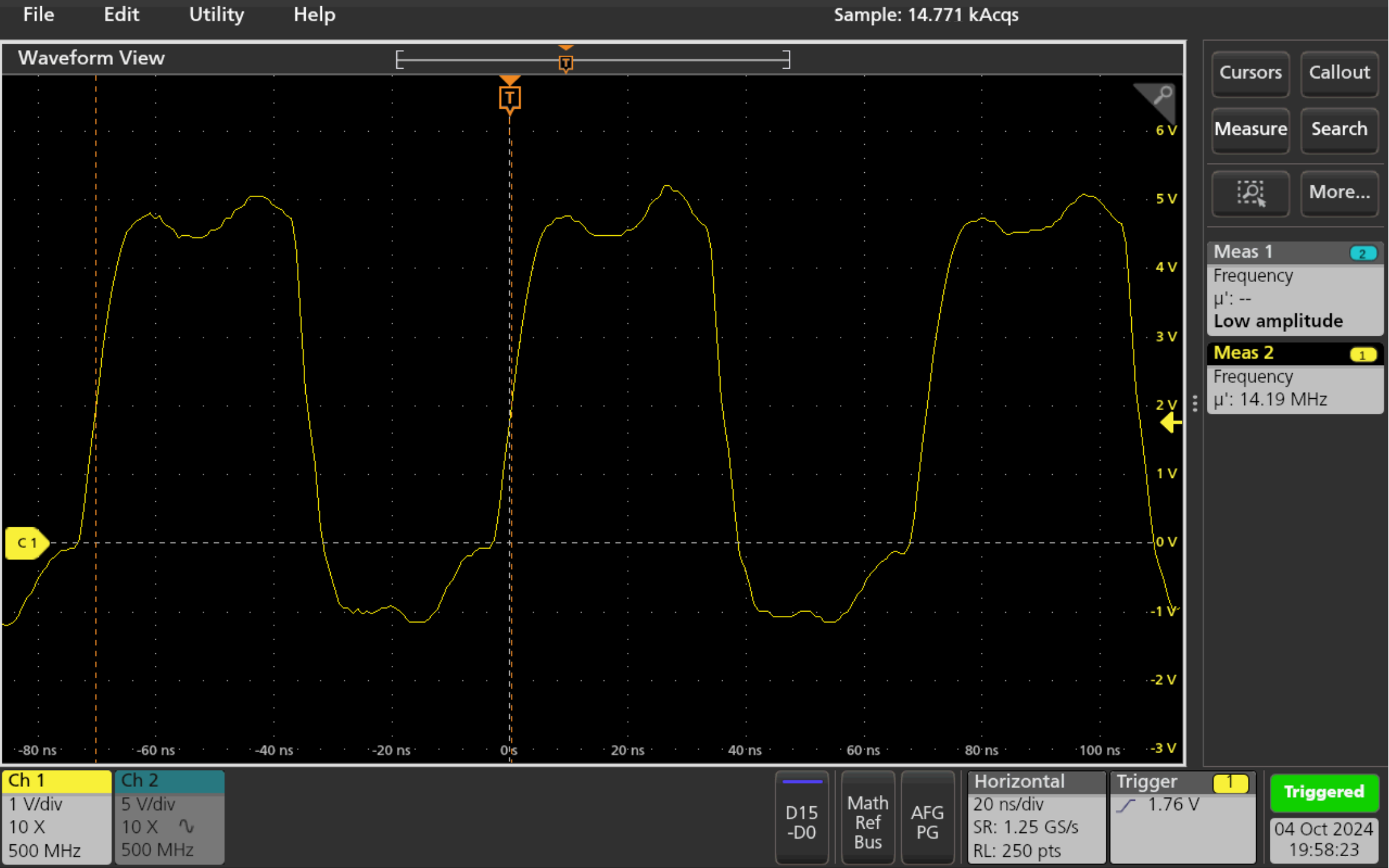

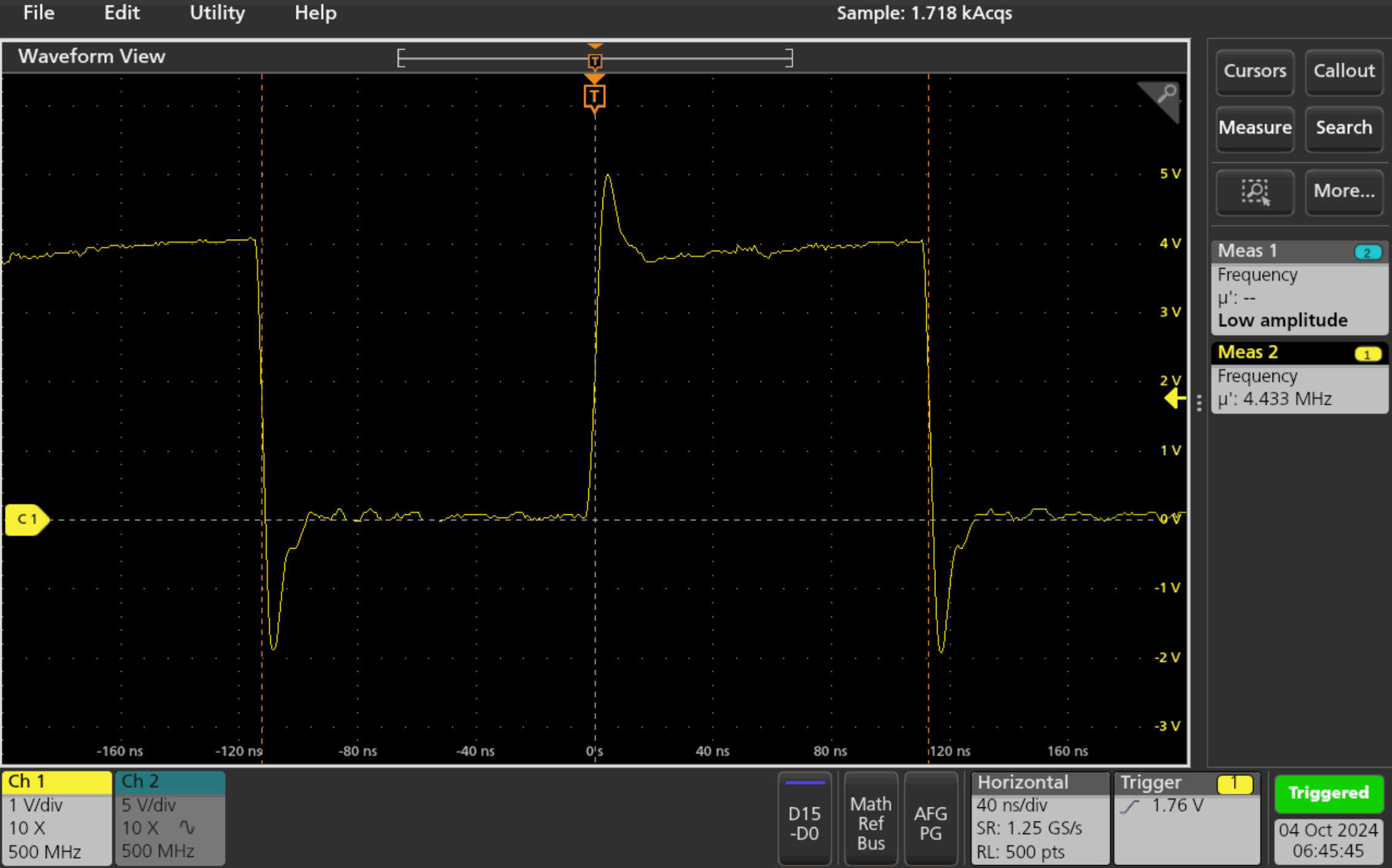

Results:
Main clock for Atari XE:
Main clock for XL:
PAL frequency:
All measured signals aren't under load. Let's test it with Atari...

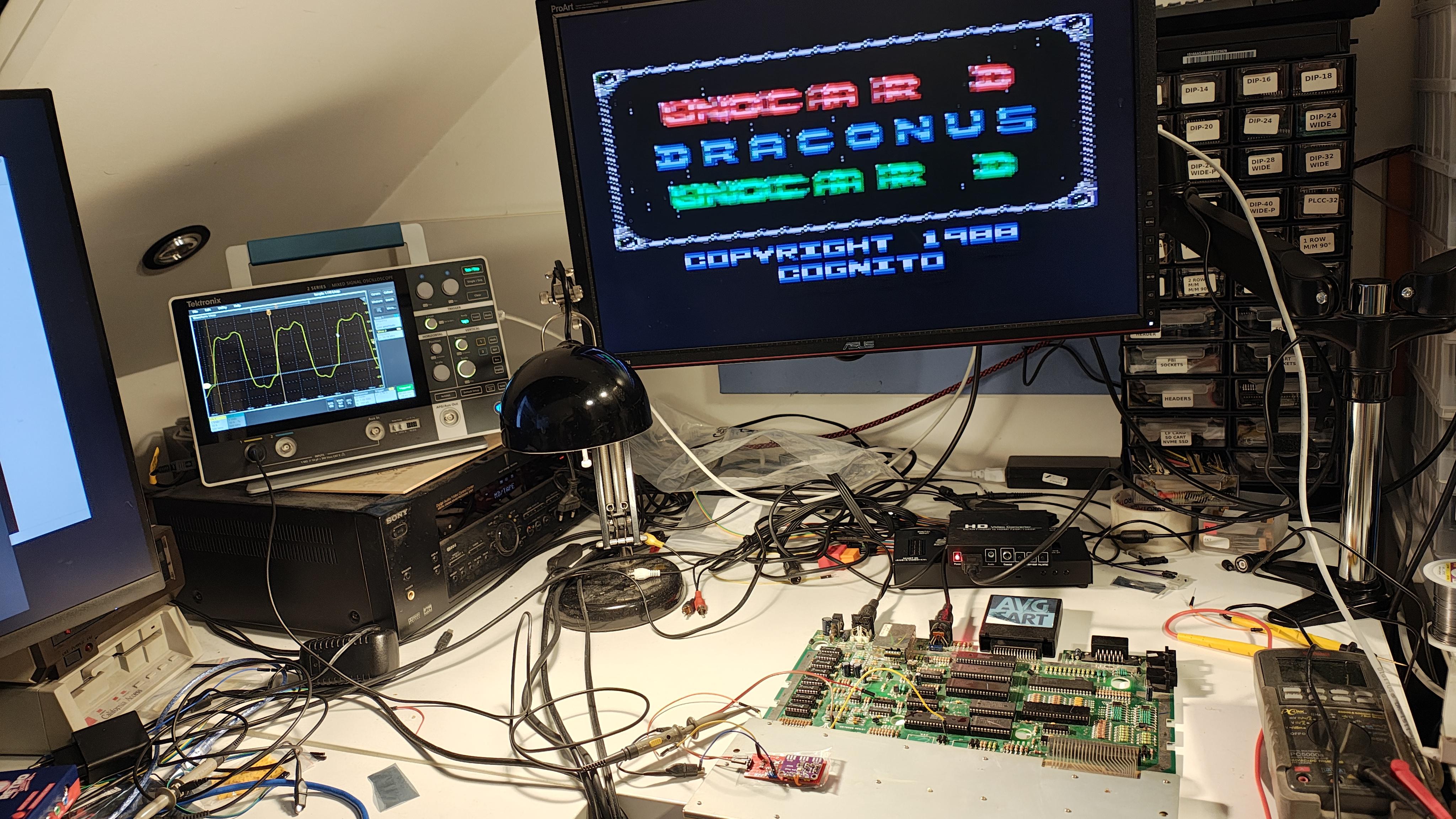

Real test

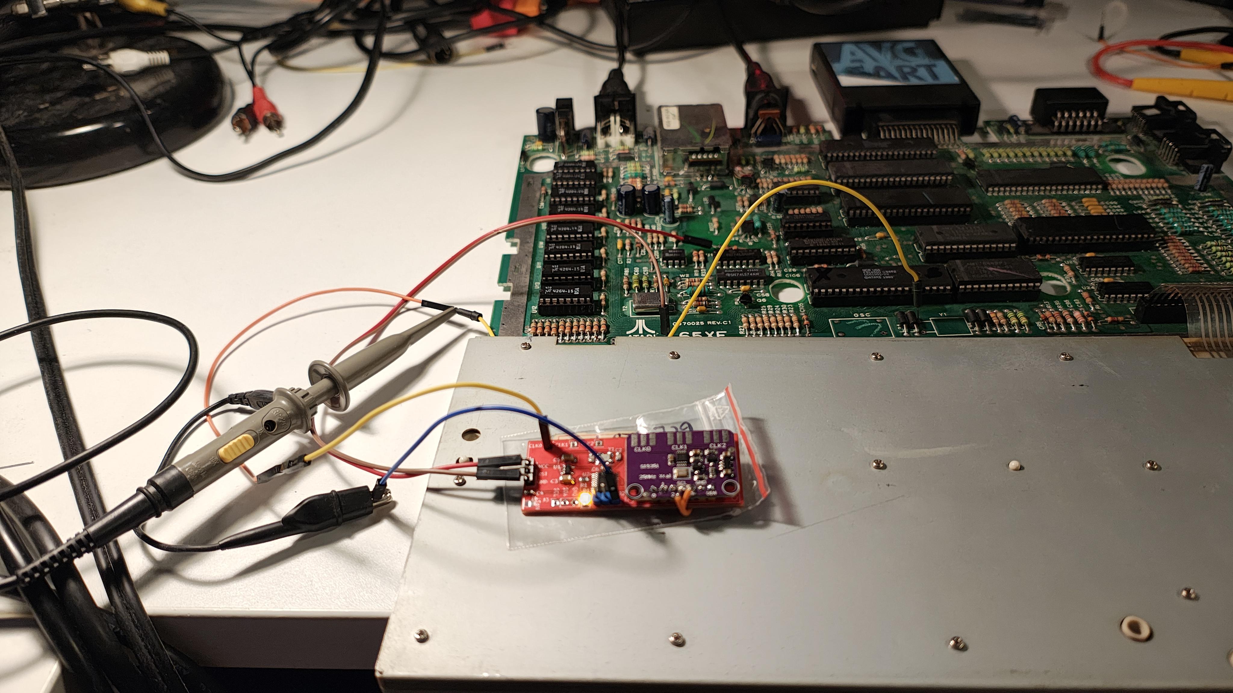

I found working board, removed oscillator and connected to 1st Freddy's pin CLK0 (14.18xxMhz). When I plugged the power I saw red screen... I thought they didn't work but when I pushed reset system started up! So the conclusion I deduced is that the clock is started to slow or... too fast. I predicted such problems and added additional RESET signal to the board. Just need to be programmed,, soon!
Connected to Atari MCM...
Work space :-)
CLK0 is little different under load...

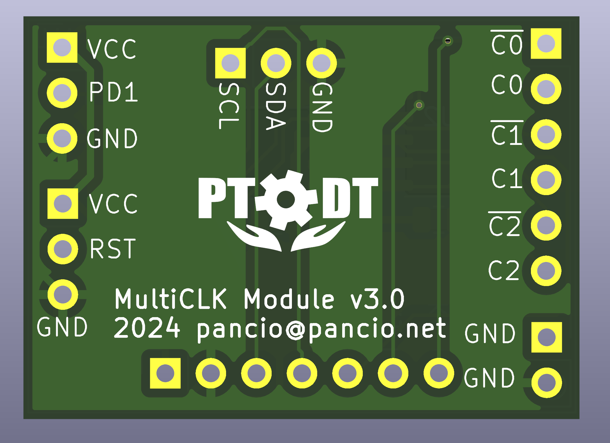

MultiCLK v3.0
I found it possible to significantly reduce the size of the PCB and get rid of several components that are not necessary for the MultiCLK to start and operate. The board size was halved and components such as the voltage regulator, quartz and several discrete components were removed. I also changed the microcontroller to a smaller one (8 pins):

1. I see some glitches on screen - don't know the reason - maybe wiring.. - need to test. - shorter wiring - problem solved.
