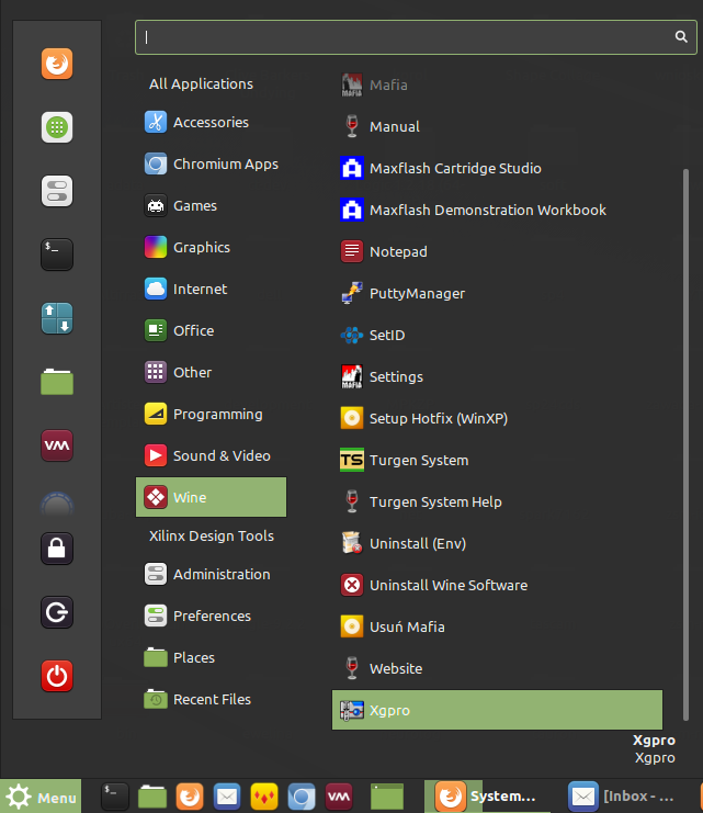

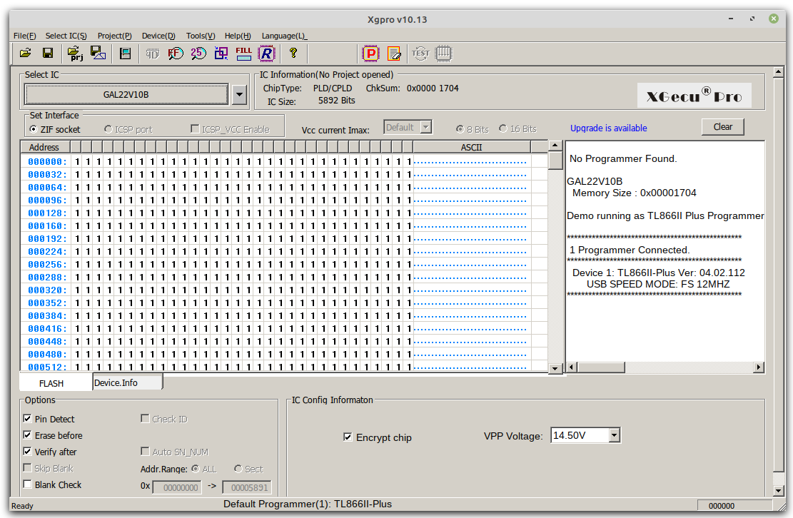

Wine - Xgpro
Wine - Xgpro
Xgpro under Linux
Xgpro under Linux
