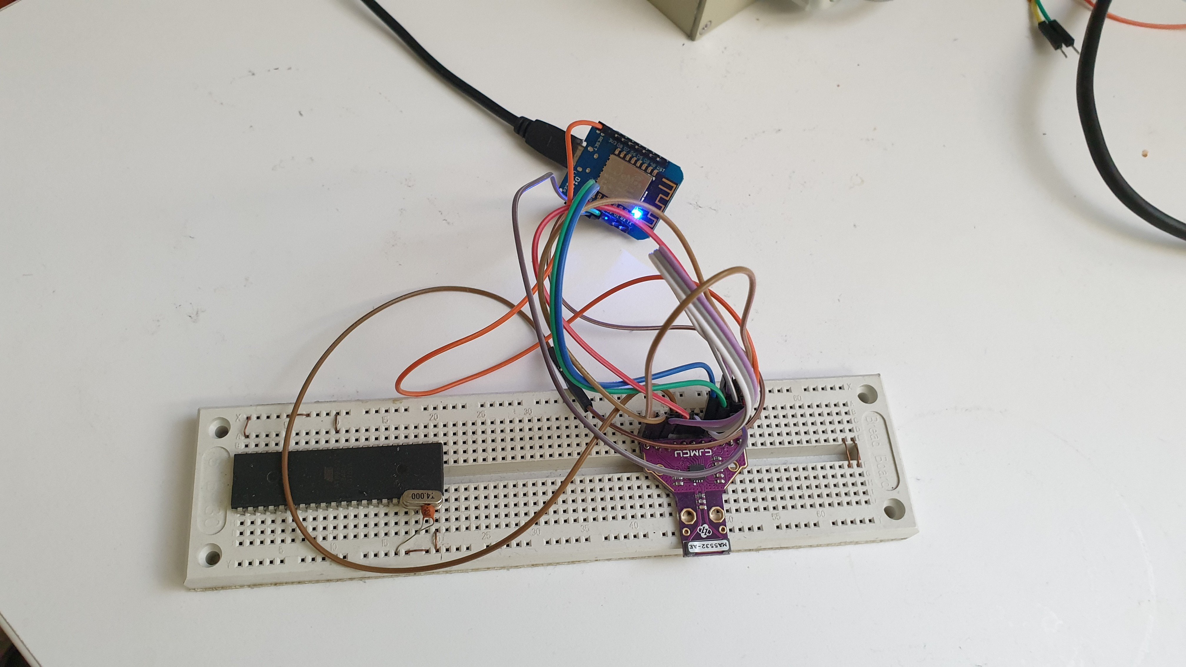

I need to equip my Home Assistant with storm detector so i found chip module GY-AS3935 made by CJMCU. It's very tiny but smart module with I2C and SPI interfaces. I Decide to use I2C with Wemos D1 mini under Tasmota. No more other staff was required...
Prototype.

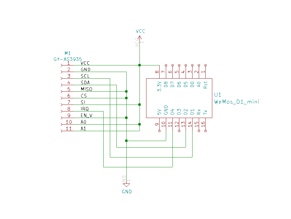

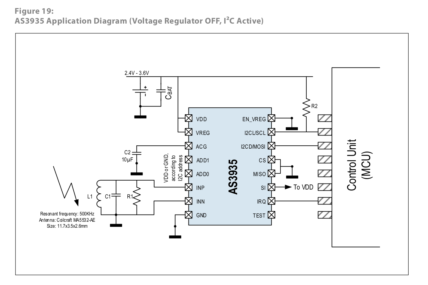

Actually you need to connect 3 signals: SDA, SCL, IRQ and 3V3/GND. Rest available signals on the GY-AS3935 you must connect to 3V3 or GND ( see attached scheme)

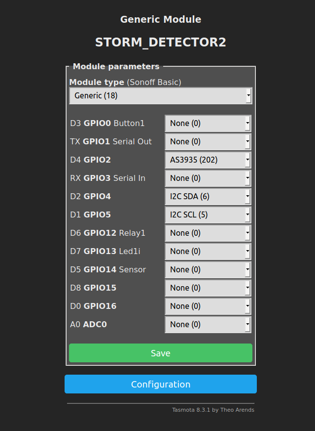

6. Set required signals.

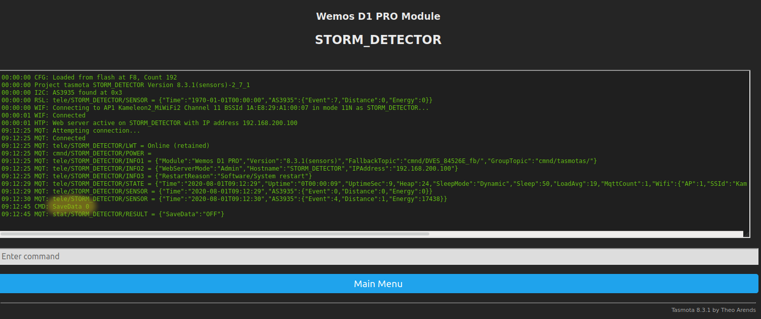

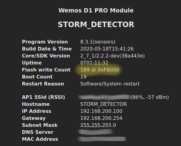

In order to avoid so quickly FLASH damage I recommending to switch off autosave configuration by using SaveData 0 option in console:
Next, you should set the gain, noise flor level etc.

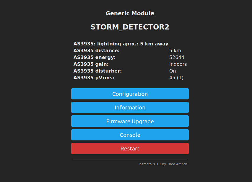

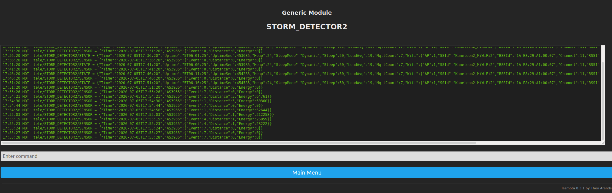

8. Checking detection

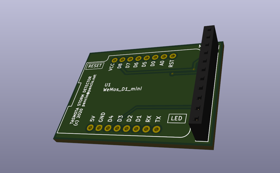

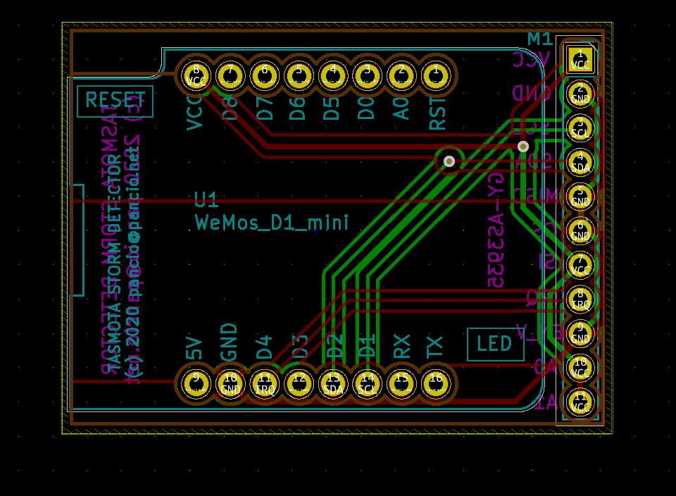

9. PCB

storm_detector.zip
Storm Detector Module GERBER's files
(24.52 KiB) Downloaded 88823 times
